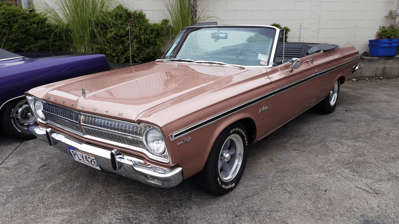

I cannot help with how to mount your new cooler....but I can assure you that having a seperate cooler is way better than using the 'in-tank' cooling system as the factory designed it. The water at the bottom of the radiator is still very hot, so I don't see how it does that good of a job.
My buddy has a '65 Plymouth Belvedere with a seperate cooler for the trans - mounted in front of his radiator....and to the battery side more so. It works well for him.
