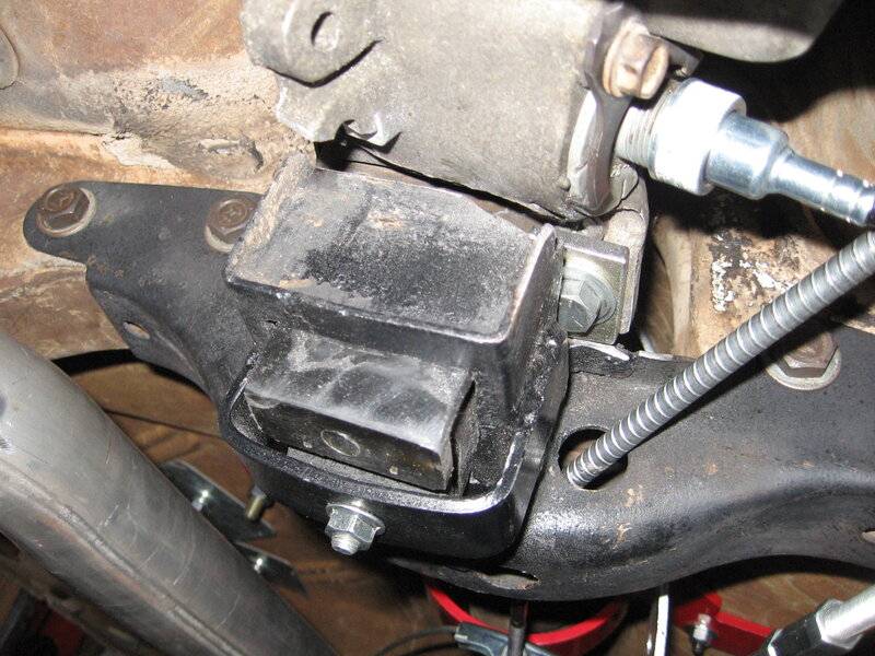

In my 65 Fury, I used a 1973 Monaco cross menber because it was set up for the newer spool mounts. I used a later style 727 trans, not certain of the year, was likely a 70-74 ish model. If your trans is further back because of an adapter plate, you might be able to get away with a simple flat plate to adapt the trans to the mount.

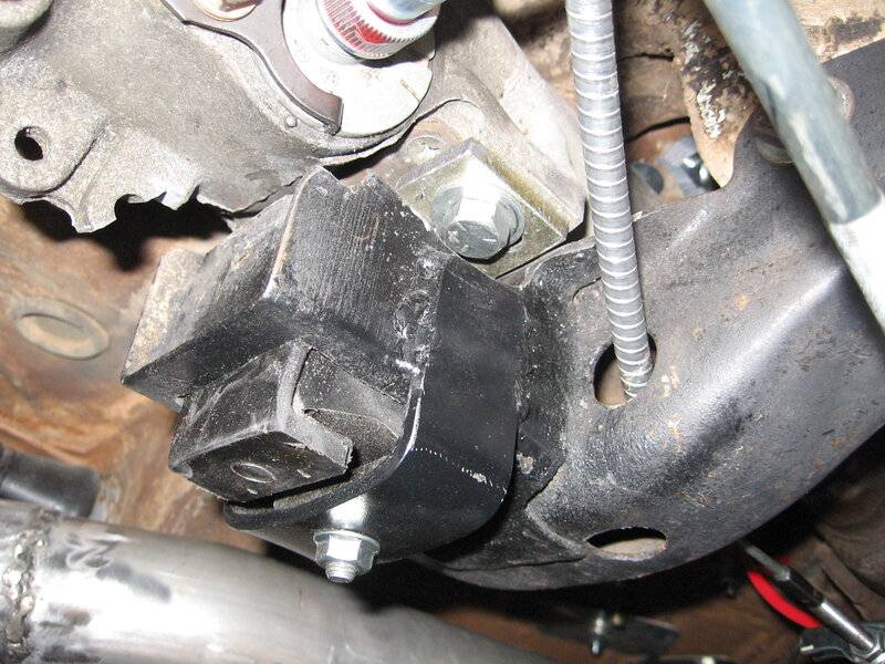

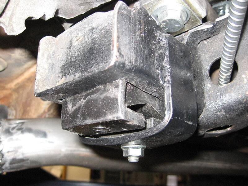

I put a 1970 318/904 in my 63 Belvedere beater. It was a Poly/3 on the tree.
I had to modify the trans cross member and used a 68 A body trans.mount.
Had to cut out the area of the 63 mount and fit the A body mount in it's place.
Then welded a strap to mount the 68 mount . It's best to measure the original so the replacement is in the same location so as not to mess up the pinion angle trans to rear alignment.Did the same to a 64 Dart when replacing a newer engine/trans in place of the factory set up. Only photos I got.
Some cutting,grinding,welding and fitting along with trial and err but it worked for me.

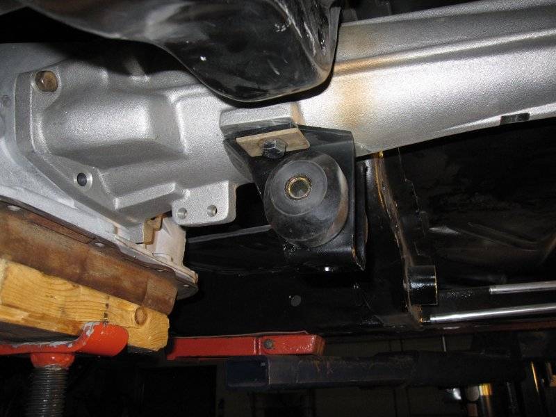

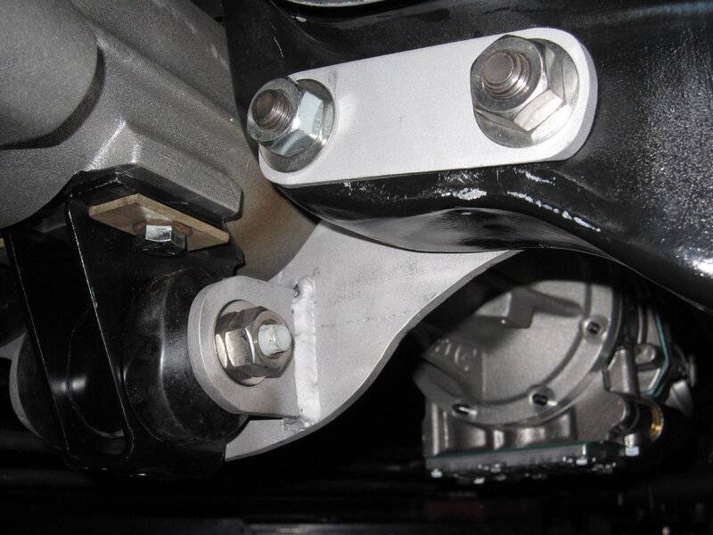

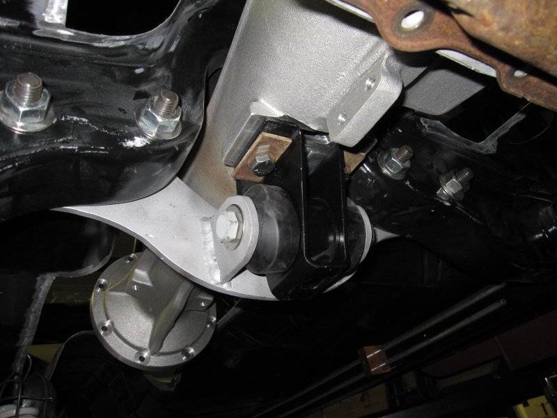

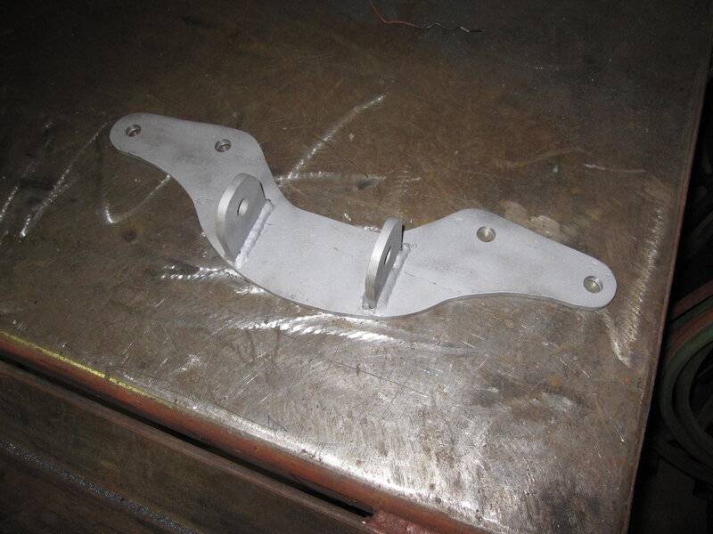

1965 Belvedere with maximum engine setback. I have a RMS front suspension but, the trans cross member doesn't know that! I used a later model spool trans mount with urethane replacement "rubber". 1/4" plate is the new cross member and front "washers". I used OEM bolts with flanged nuts (because I had them). I just used cardboard to make a pattern and torched it out. Pretty easy fab. I probably should have cut some lightening holes to reduce more weight.
Mike
Awesome! Imitation being the sincerest form of flattery, I am going to copy your design. I'll let you know how it goes. Thanks!
I glad I could help. Did you notice the GV extension housing? I had everything mocked up to get the drive shaft where it needed to be. I also drilled a hole to accept the E-brake cable.
Mike

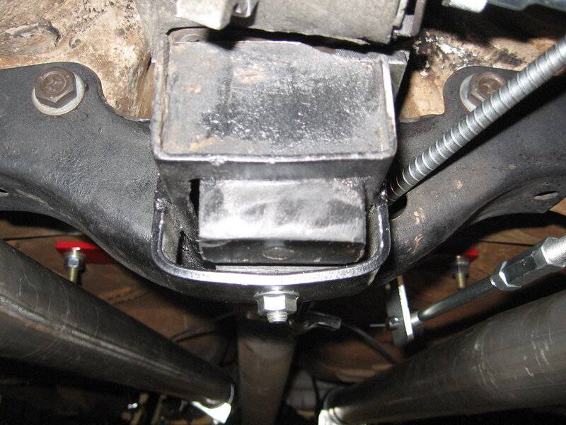

I used a later issue factory cross member and mount. You just have to cut the ends down as they are to long as the hole spacing is wider on later b-bodies. Once cut to the same length slice the vertical sides a little until when pressed up the inner holes line up, mark & redrill the outer holes like the original crossmember.
Mike's placement of the gear vendor tailshaft is exactly where mine is, with the trans mount holes essentially in the center of the cross member. I have fitted the later mount and made a cardboard template. Next up is a 3d print to make sure the fit is good before I make the steel version. I will add pictures as I have them. I did not have an original transmission to refer to. Is there a standard position for the yoke on the back of the transmission? Distance from top of the tunnel? Is it centered in the tunnel? Any help on setting the correct location for the trans mount welcomed.
In pursuit of transmission support, you must be mindful of driveline angle. Shoot for stock angle and everything should be fine. There are discussions on this site that will guide you.
Mike
