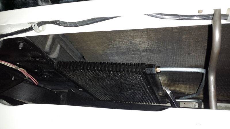

I'm using a Trucool LPD 4707 cooler. It has 5/16" inverted flare bosses so it can be hardlined to the radiator and transmission. I'm not a fan of rubber lines.
https://www.oregonperformancetransmission.com/product/LNG-4707.html

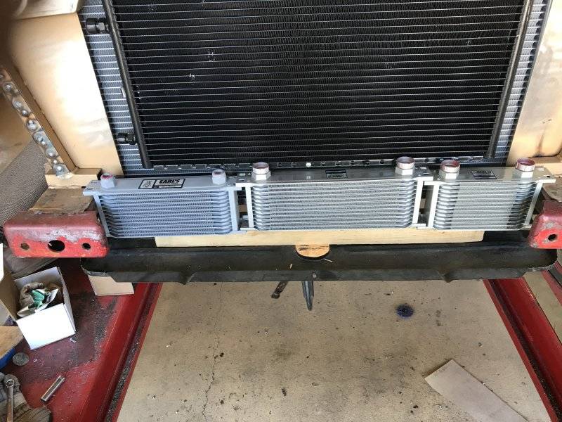

My trio of Earls units. Engine, trans and p/s. Mounted on top of the stone shield behind the bumper.
