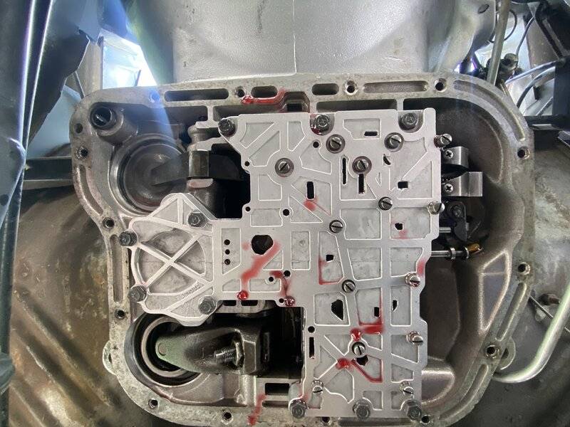

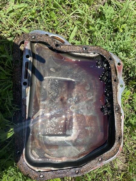

Thanks everyone I will purchase the trans x additive tomorrow and will let everyone know what the results are. I did go ahead and adjust the front and rear bands today just to eliminate that from my possible issues. I made a mess when removing the pan and it was a pain finding a socket to fit the square head stud. Luckily I found and 8 point 5/16 and it was a perfect fit.

The bands have ZERO to do with 3rd gear. If you would take the time to check governor pressure that would be a start. The governor and governor seal rings can be accessed without removing the trans. If the 2/3 shift valve is stuck it can be accessed as well. As long as the reaction shaft support rings and the front clutch seals are ok you should be able to repair this in the car. But wasting time adjusting the bands and adding magic liquid is not the answer.
