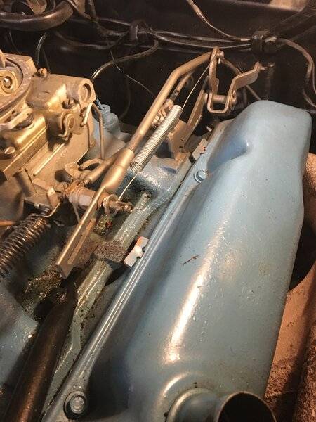

I was having the same shifting problems with my 1969 Super Bee, 383/auto. Sometimes it would shift fine, other times it would hang up in a gear and not want to shift to the next gear. I thought a rebuild was in the works. I had to remove the carb to lift the motor to replace motor mounts and during the reassembly I found the return spring for the kick down linkage was missing. That spring keeps the linkage pulled forward. Without the spring the linkage would float around about half way to the rear, simulating a desire to kick down. I installed a spring and everything was great. It shifted like a new transmission. It would be great if your problem is this easy to fix. It's the shiny spring in the picture.
