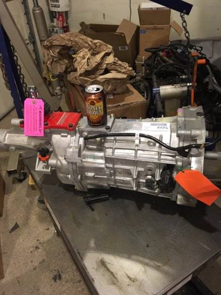

I have decided to swap my Tremec TKO 5 speed for the T56 Magnum 6 speed.
Even though I feel the TKO 600 has been a great transmission and has only a thousand miles on it.I have driven a couple of six speed cars and feel that the six speed would work better for
what I am doing with the car.
I know others have done this conversion and thought I would do a thread on my installation.
The transmission arrived this weekend.Sorry about the photo I was doing some celebrating.

I bought and installed one a few years ago. I also went with a Quick Times scattershield which gave me the conventional clutch linkage. I previously ran an earlier T56 and cleaned 2nd gear out of it. No worries about that happening with the magnum.
Good luck with your new Magnum!
How much horsepower can those TKOs take versus the T56?
I believe they are rated at near 700 HP and 750 Torque. 6th gear is around .63 overdrive, where the T56 was .5. Had mine on the strip for a few passes and had no concerns about breaking anything. Far stronger than a T56 and I found the T56 was much tougher than the Super T-10 or Muncies. I've crunched them all except the magnum.

Awesome!! The big difference I noticed was quicker smoother shifts, the T56 being a single rail shifter makes it smoother.
