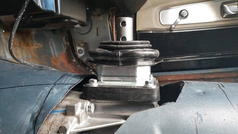

Here is a TKX behind a 6.4 crate Hemi using Holley mounts in a 67 B Body. Height of shifter "tower" and contact with the drivers side of tunnel result in more mods being needed than I hoped. I think I would get the tranny needed to match the power output of your engine.

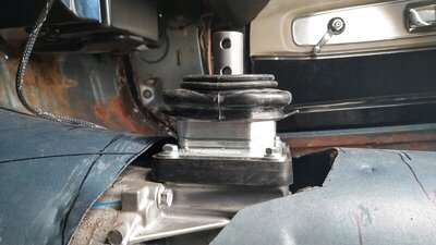

Awesome, a 6.4 crate engine is definitely a possibility. did you consider the SST "perfect fit" kit? I'm wondering how well it fits.
I am using the SST kit but it is designed for tranny to be in stock location. The Holley mounts move the engine about an inch farther forward so I had to lengthen the slots in the tranny crossmember to get the bolts in.
