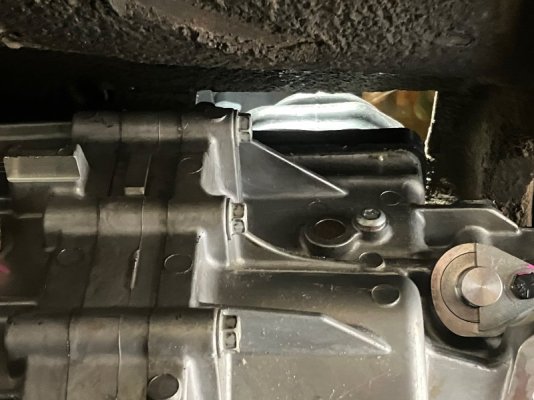

CoronetDarter, would it be possible for you to take pictures of the clearance of the trans to the torsion bar crossmember? Specifically around the shifter/rear shifter plate and the clearence around the driver side where the hump would be and the case of the trans (i know you dont have the 4 speed hump of course) thanks

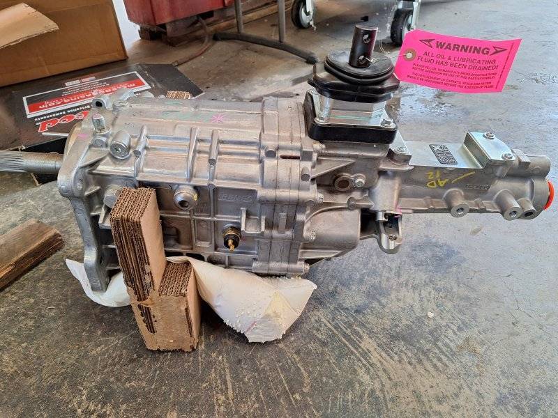

They use the Ford trans because the length of the input shaft Is better suited for the Mopar application & Tremec doesn't offer a Mopar version.... The "Belair" shifter would work on the Ford TKX the same way it works on the GM TKX..
Here's another offset shifter..
Yea right on I saw that one too. That one won't work though as the shifter would directly interfere with the t-bar crossmember. It needs to be more forward to get close-ish to the stock hole. Obviously since its not an engineered kit but at least close to the ballpark would be nice, assuming someone with one already installed could provide some measurements and pics. It would be nice if they actually bothered to make a 66-70 perfect fit kit like they did for the e bodies. I feel like it's a huge market they are losing out on. It's the bulk of the cars people would actually pay to get a proper overdrive and have fun driving. There are way more 66-70 b bodies out there then 70-74 e bodies..
Been a busy weekend and I'm just catching up to posts tonight. I can take some pics next weekend when I'm back in the garage.
You already having a 4 spd tunnel, I understand why you want an offset shifter.

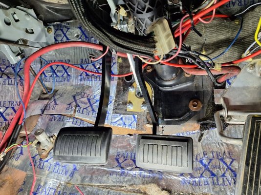

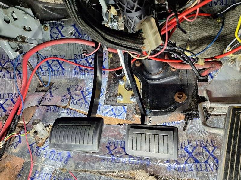

Basically, the interior had to go back together. I drove back from Greg's house with only the drivers seat bolted down. Before starting, there were a few under dash items to tidy up.
When I moved the battery to the trunk, I home-runned the 1/0 cable and the wires from the solenoid up through the firewall. As posted earlier, the 1/0 cable had to be re-routed before the 3rd pedal was installed. There's an 8 ga red wire and 12 ga blue wire running to the starter relay, and both wires were about 18" too long, leaving unsightly service loops under the dash. Both have been shortened and routed away from the pedal assemblies.
This pic, taken back in October after the clutch pedal was installed, shows the unruliness. The 1/0 has already been re-routed. The 8 ga parallels the 1/0 to the steering column, and then you can see the service loop zip tied to the steering column. The blue wire is looped on the far left, by the E-brake cable. Plain messy. The 14 ga pink wire looping down by the high-beam foot switch is left over from the EFI system; the other end is disconnected in the trunk.

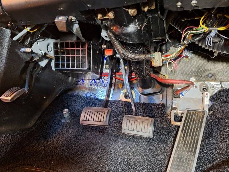

Now, the service loop is gone and both the blue and red wire parallel the 1/0 with zip ties, before arcing upwards thru the firewall. The pink wire was cut back to the plastic sheathing. In this pic you can see that the carpeting, accelerator pedal, kick panel and fresh air box have been installed.

thanks for posting those pics. So looks like there is not enough clearence on the front of the driver crossmember with the gm a-body trans which is a bummer. It seems to be about the middle of the crossmember where the OP had cut the one mounting boss off. So carefully judging by the pics its not gonna work

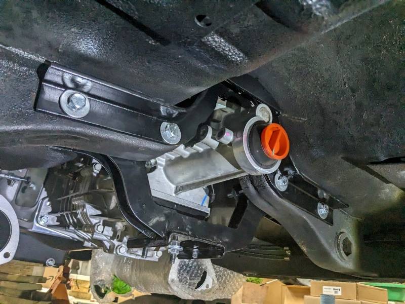

I went with the center shifter location because I was going with a modern center console. Unfortunately it puts the shifter right in the middle of the cross-member. I had to build a new bolt in piece to reinforce what was cut away.
I'd like to see a pic of the top side with the console.
