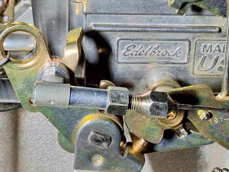

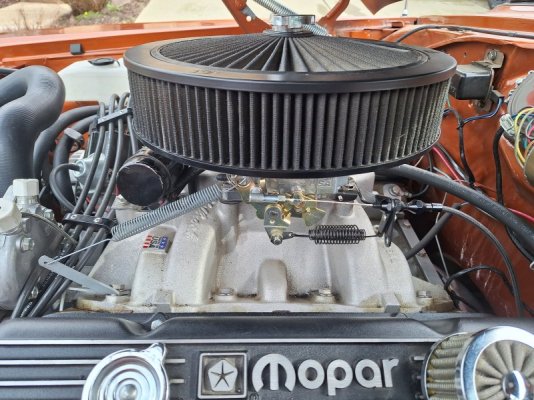

The other pebble in my shoe was the throttle response. I'm running a Lokar throttle cable, and had a Lokar kickdown cable with the automatic. After removing the kickdown cable, the tension increased slightly on the throttle cable, not allowing the throttle plates to snap closed at idle.
I dug up the original throttle return spring, still freshly painted. The spring helped some, but warm idle was still around 1100 rpm. The carb-end assembly on the Lokar has a threaded stud with locking nut, allowing precise adjustment. A couple of turns and the throttle was dialed in.

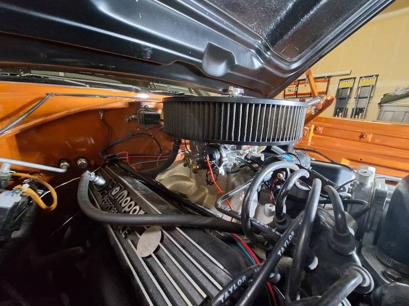

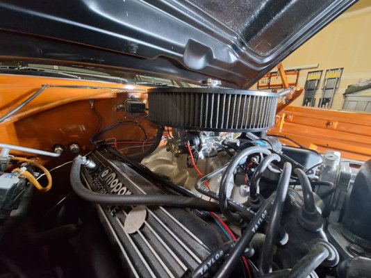

I also want to point out the height of the air cleaner assembly. Back when the car was still at Greg's, he rebuilt the assembly, welding on a longer neck to the bottom of the drop-base. Originally I needed a drop-base for the air filter to fit under the stock flat hood; with the six-pack hood clearance isn't an issue. But the base was impinging on the choke housing, leaving a gap.
Now there's plenty of room underneath.

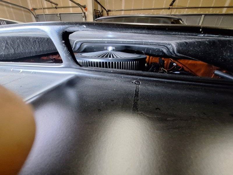

And at least 2" to the bottom of the hood scoop.
