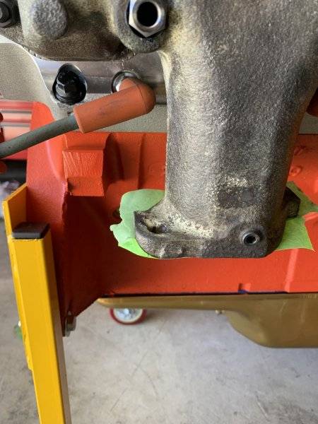

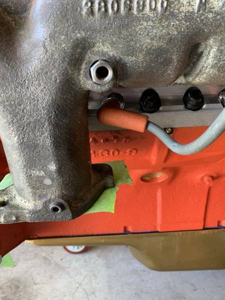

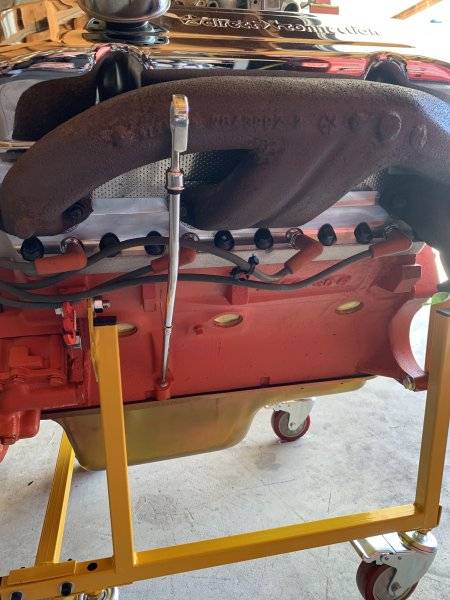

Having a 470 BB built. Using Trick Flow 240 heads. Will there be any issues using Xp exhaust manifolds with these heads? Will there be spark plug / wire issues? I am concerned about them being angle style plugs.
Drivers side is clear passenger side you will want to run heat sleeves on #6 and 8
