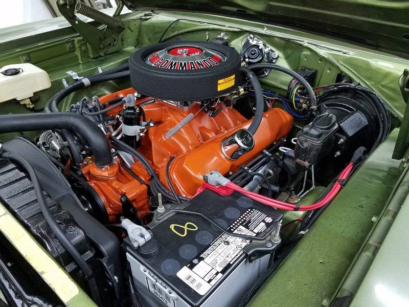

i have built a 505” Trickflow 240 engine that retains the oeiginal Six Barrel cast iron intake manifold and carbs. The block was just cleanup decked. It runs very well and we dynoed it with both a Holley Street dominator Intake with Holley 850 and then with the Sixbarrel setup with factory air cleaner.
The results were:
Street Dominator
635 lb ft @ 4400 rpm
594 hp @ 5400 rpm
Factory iron Six Barrel w/ factory air cleaner installed
608 lb ft @ 4300 rpm
576 hp @ 5400 rpm

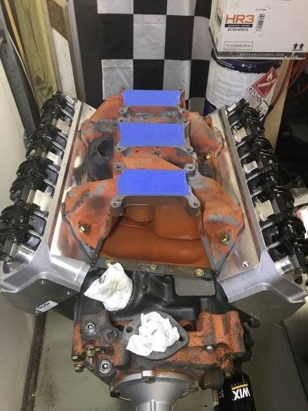

You both are welcome. Here is another pic to show little more detail:

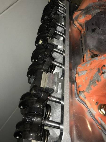

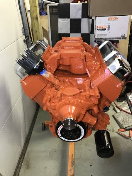

Here's a photo of my 505 Stroker with trickflow 240 heads painted up to look stock. I had to clearance the baffles in the valve covers to clear the roller rockers.
That's awesome! This is exactly what I'm after.
Are you running exhaust manifolds? Hard to tell from the picture.
