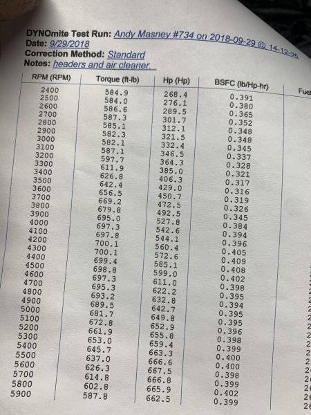

The results were:
Street Dominator
635 lb ft @ 4400 rpm
594 hp @ 5400 rpm
Factory iron Six Barrel w/ factory air cleaner installed
608 lb ft @ 4300 rpm
576 hp @ 5400 rpm
Mine results are very similar, but with ported Eddy Heads, not TFs, and minus headers.
Street Dominator
599 hp @ 5800
616 lbft @ 4400
Six Pack
570 hp @ 5600
595 lbft @ 4200
