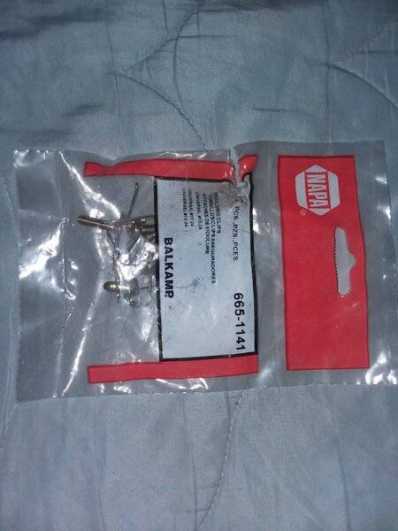

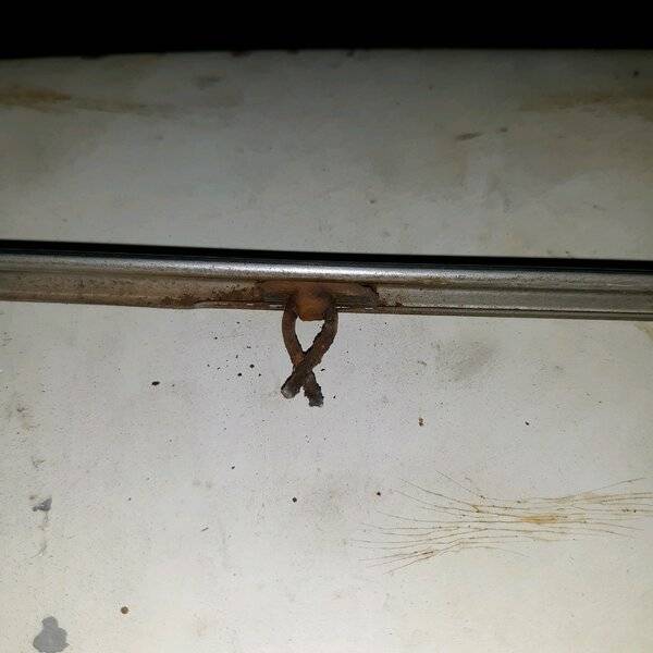

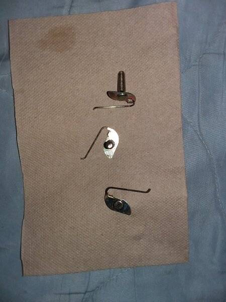

@funnycar Do they have to be those exact clips, or are you just trying to hang some stainless?
I needed to hang some 5/8 wide stainless on my 62 savoy, and i read from someone on this forum (thakyou, whoever you were!) to try napa. I went to my semi-local napa dealer, and found a rack, out in the open where i could get at it and shop, with all kinds of clips on it. I found a few of the packages shown, looked like they had been on the rack for a decade. I bought three packages, if memory serves, $5 for eight clips per pack. I cut off the spring arm with a cutoff wheel, smoothed then out and they installed perfectly. They dont come with nuts, so i bought a small pack of flat washers and10-24 nuts. Replaced the exact clip you show .
