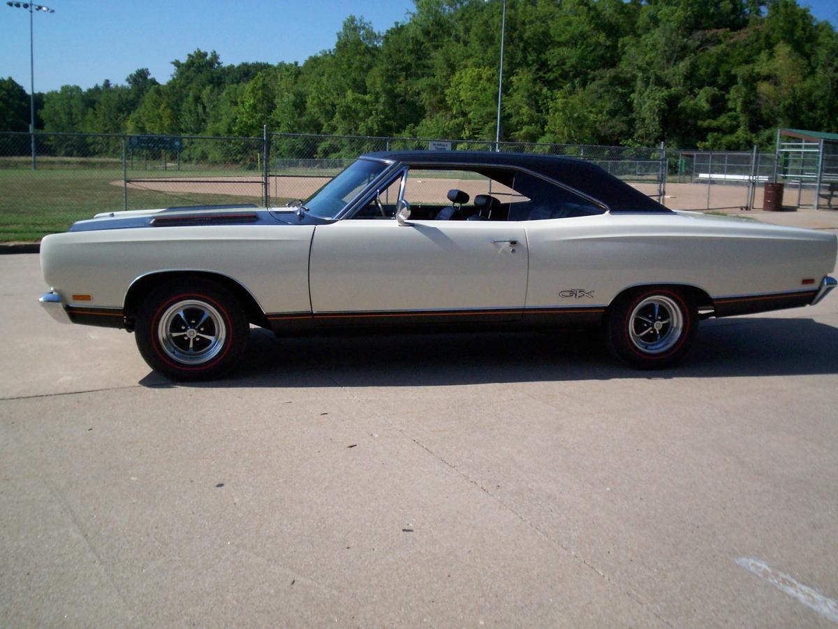

My "new" 1969 GTX shoulld arrive next weekend, and sometime during the next 6 or so months I would like to change the single 4 barrel to trips or quads. I have always been under the impression that trips are more for show than performance, and the quads are the big power producers.
I am leaning towards the dual quads, but was wondering if anyone makes an air filter system that will fit quads and the air grabber that is on the car. I don't want to give that system up.
Thanks

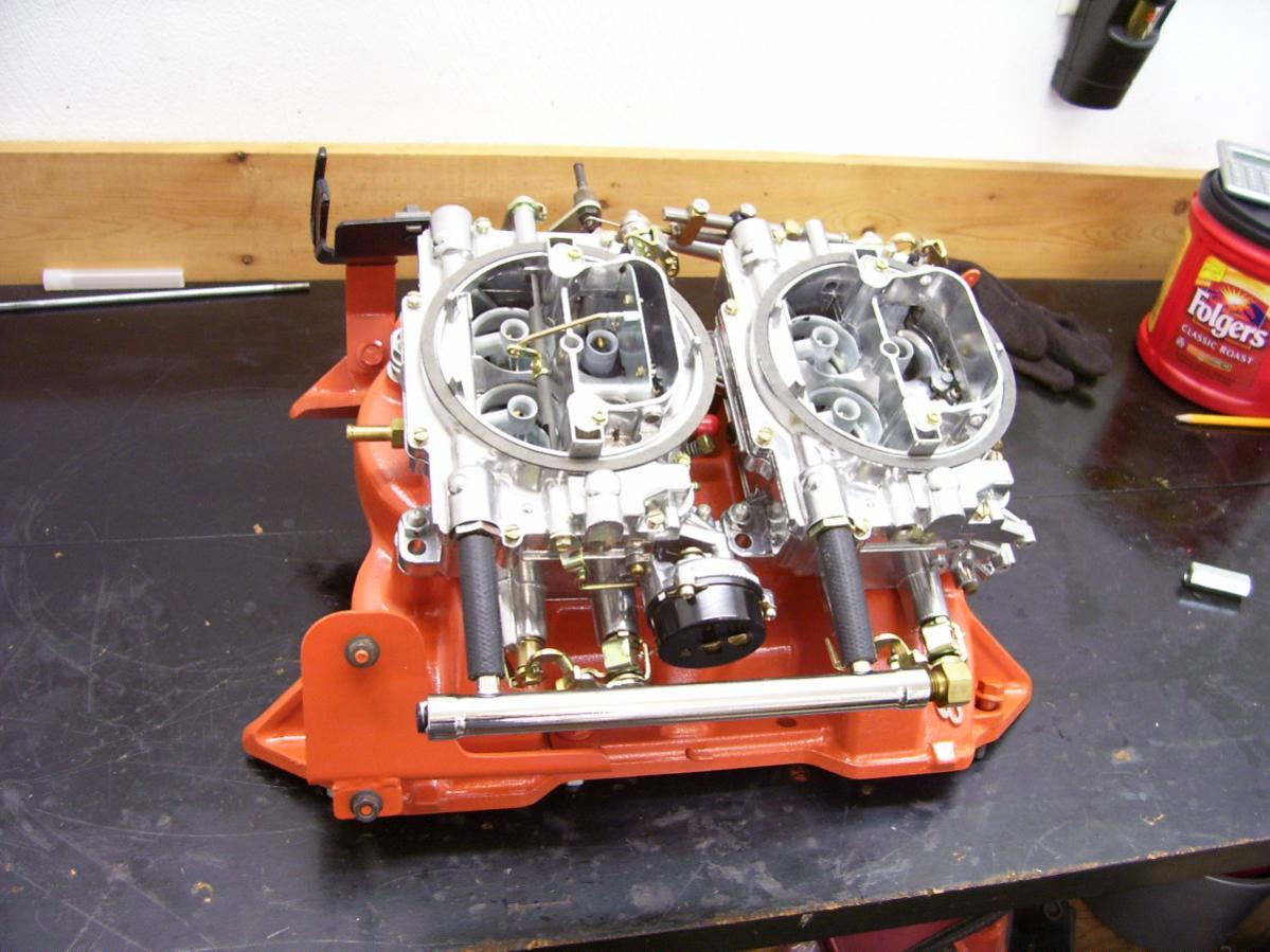

pic of the dueces on my 69 r/t. the car has the ramcharger fresh air stuff so the '70 air cleaner, linkage and stuff all work. if your car has the fresh air package than the 6bbl with a '70 air filter is a bolt on. as far as performance goes the car ran ran 14.01-99mph pure stock, 3.23 rear. automatic. same set up with 6-pak got down to 13.13-106mph. so much for multi-carb is for show.
pic of an edelbrock ch28 and carbs with some extra things i've fabbed. this would probably be a nice street/street-strip set-up. less expensive than a 6bbl but should perform well.

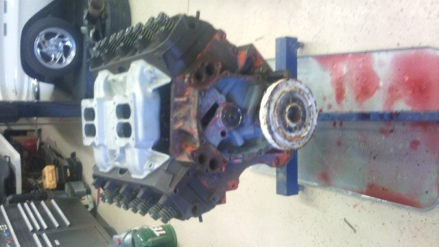

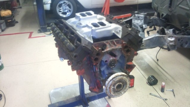

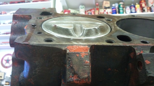

If gas mileage is a concern I would run the six pack, since it will only run off the center two barrel unless you put your foot into it. dual fours makes more sense to me ( 1 barrel for each cylinder). This high compression dual 4 383 is going in my 68 dart soon.
