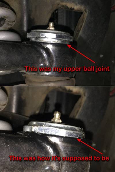

Last weekend, I hit Willow Springs again and after a few laps something didn't feel right about the car. I went faster, and knocked a couple more seconds off my time, but I quit running mid-second-session because I didn't like the way the car felt. Two nights ago, I was replacing my race tires/wheels with the street setup and I noticed the right front wheel was moving a little too much.
Rest of the long story short is that I found one control arm bolt loose because the proper washers weren't used (alignment shop I blame for this - they won't get my business anymore) and all four of my ball joints were never torqued down properly. The right upper ball joint had actually backed out far enough that the threads were barely engaging, hence the movement I found. They weren't coming out prior to this because I've swapped the wheels a few times and didn't notice that additional movement, but I'm sure pushing hard at the track helped to loosen the one ball joint up a bit more.
I contacted my former boss and told him how unhappy I was, and that I was throwing my car into turns at 100+ mph with loose ball joints. He was 'concerned', and glad nothing catastrophic happened, however, he didn't really react about me saying his technician put out sub-standard work, and through his negligence it could have been far worse. I have to replace parts and get the car completely checked out and a new alignment done, to which he didn't even offer to pay for. This is why I'm so glad I don't work there anymore.
I tightened/fixed everything last night and test drove the car... it's amazing how smooth the front end is now without all that clunking and extra movements that I couldn't nail down before. It makes it very hard to trust shops anymore, the alignment shop I trusted never caught the loose control arm bolt - which they adjusted!
