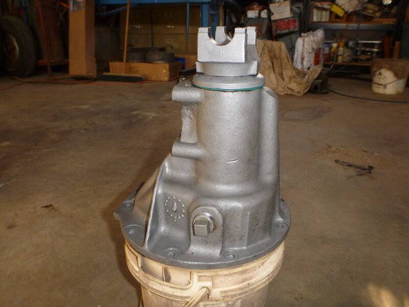

Here’s what i soaked my parts in
Diesel fuel mixed with some motor oil is what I use to soak some parts. Also a empty 5 gallon metal can of racing fuel will probably fit it. It's a little bigger around than a plastic bucket.
