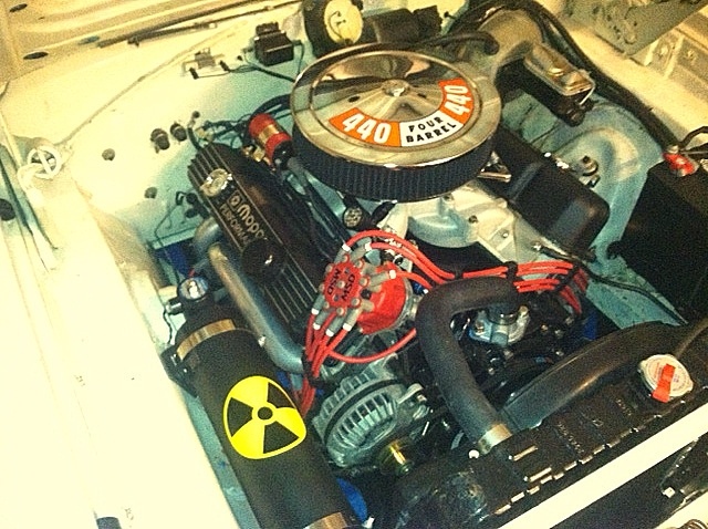

Running TTI headers on a 440....no complaints yet.
:thumbsup:

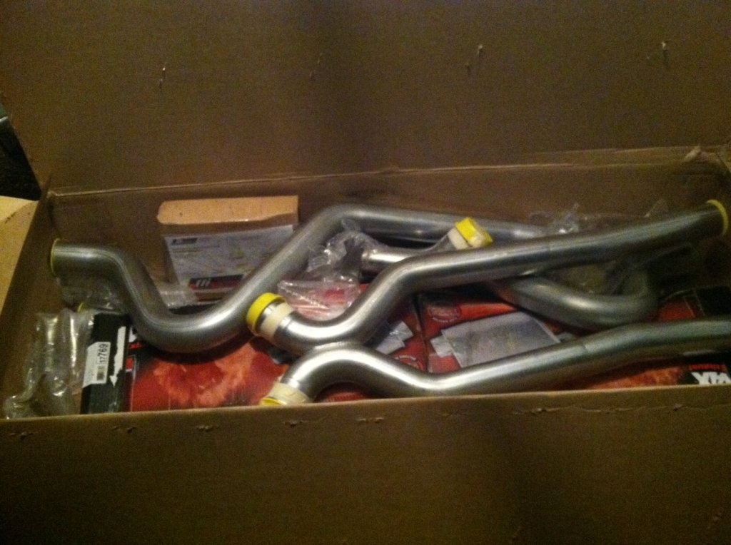

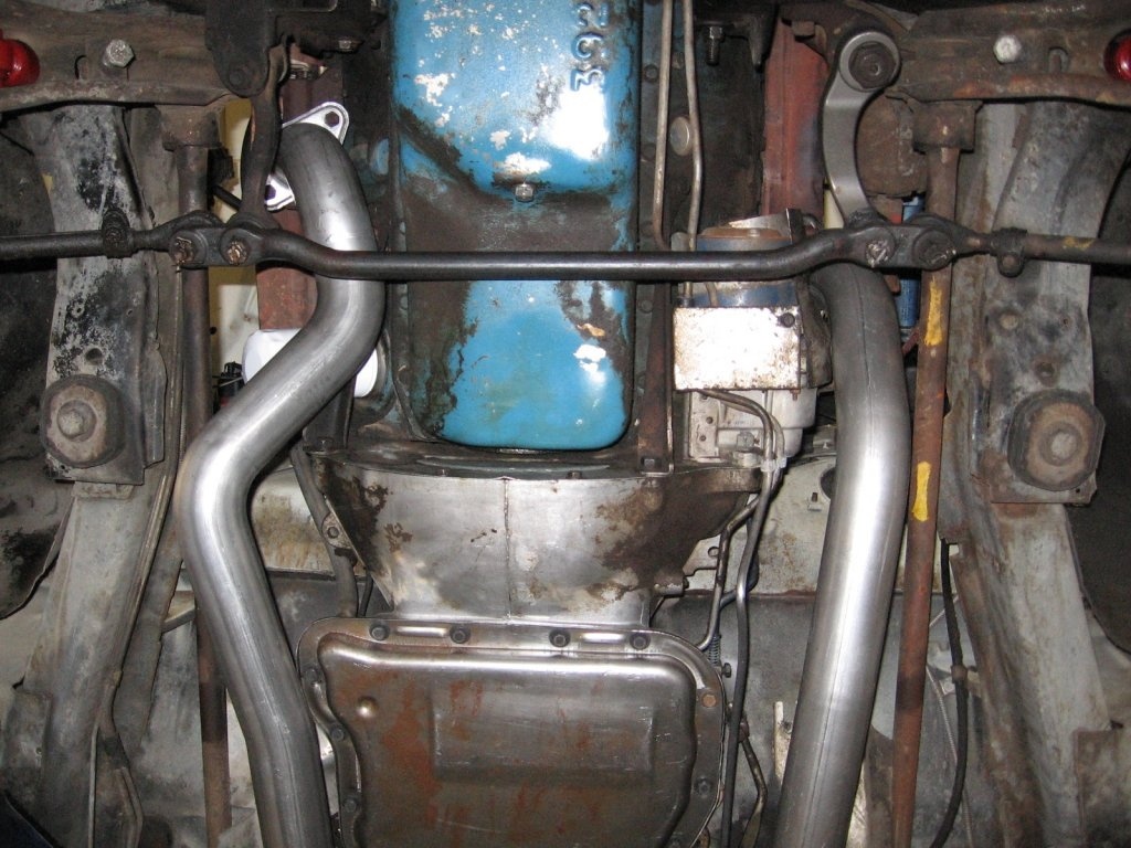

493 PUMP GAS STUMP PULLER ,TTI HEADERS ARE GREAT. 440-200 POLISHED /CERAMIC ONE 3" TTI X-PIPE SYSTEM WITH DYNOMAX SUPER TURBO MUFFLERS.THING I DID WAS HAVE THE MUFFLER SHOP WELD UP THE SYSTEM TO GET RID OF ALL THE CLAMPS AND FLANGE THE X- PIPE(MID-PIPE) SO WHEN I HAVE TO PULL THE TRANNY I DON'T HAVE TO DISTURB THE MUFFLERS AND TAIL PIPES

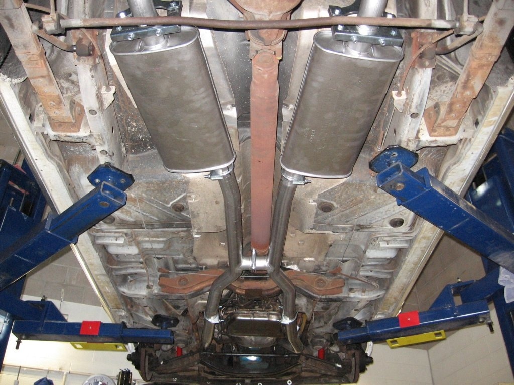

Been running TTI 2" headers and this TTI 3" full exh system on my 63 for 5 years now with zero problems as it worked great. Ron
View attachment 332678 View attachment 332680
Which finish is that on the headers? How's it looking now?
THEY LOOK GOOD SO FAR . ITS ALMOST A YEAR SINCE INSTALL ON NEW MOTOR, JUST GOT TO HIT THEM WITH A LITTLE MOTHERS ONCE IN A WILL, AND DON'T USE THEM FOR MOTOR BREAK IN, IT COUND DAMAGES THE FINISH AROUND THE PRIMARY TUBES AT THE EXHAUST PORTS IT ALSO VOIDS THE WARRANT

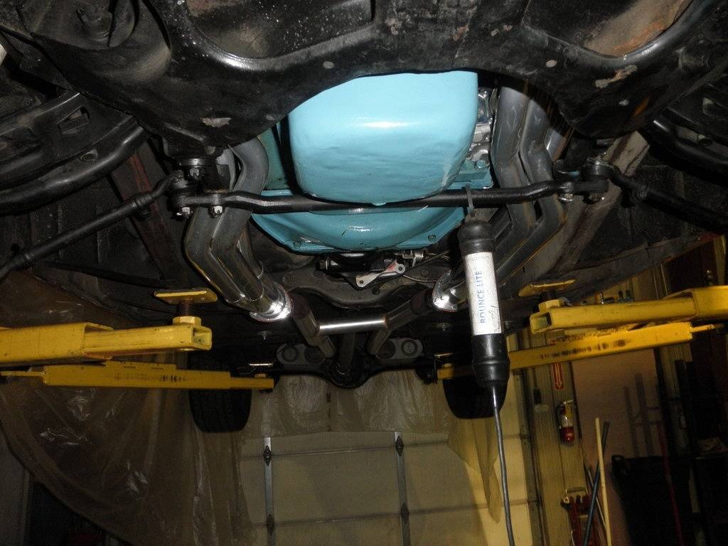

Pictures of TTI exhaust on a 79 300.Iron manifolds
Coated and Ceramic here. Had them on for about 8 years. Good fit, no problems. $1000 to the door - just the headers. Buy from a vendor here on FBBO, not direct unless at a Show with discount.
Forgot to mention that the "Kick out" of the pipe on the passenger side of the 300 makes it easy to R&R the oil filter.

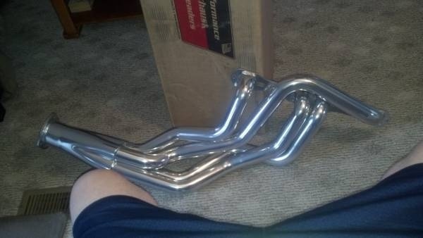

So against my better recommendations my uncle ordered and installed Hooker headers and low and behold they are leaking...
Check out the picture below, notice the holes below the exhaust ports on the stock manifolds? I'm guessing that has something to do with emission stuff. The new headers do not have those holes and we can see burn "witness" marks on the gaskets that we pulled out to replace the gaskets that correspond with those holes.
Any suggestions?

(RB Block)my TTi headers (now 5 or6 yrs old) ....used NO gaskets, just Use a very thin layer of High-Temp Silicone Sealer. (see fit below)they sealed up beautifully!
BTW,#(RB block)I also had Hooker, (also B body ) they kept leaking so I cut the "bar" holding the tubes together...then they sealed up....
