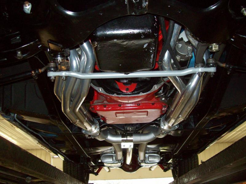

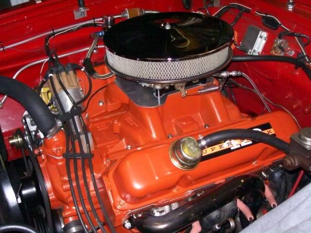

101_0023.jpgSpend it now and coat them with TTI, decreases heat and look great!
Black would be my choice too, not a huge fan of the silver look. Maybe old school white! ha ha ha
Did they coat the insides of yours too?
Reed
From what I could see they did Reed......Wish TTI or Dougs would come with a black coating though. Saved myself about $10...lol Take out gas/travel, probably upside down. Ah well, at least they are the higher temp black I guess
I have the chrome TTI's on my Coronet, (my nephew bought them but never used them, I got them for $300.) They've been on the car for ten years....8 years as a daily driver. This is NOT a show car, so I could care less if they're discolored. Never any leaks...they've been through tons of heat, driving in L.A. traffic and to Vegas many times with 3.91's, buzzing at 4 grand the entire way.
The ceramics would be nice though...I'll give these another 10 years, and maybe change them....LOL!!
...Thanks Cuda chick for your insight. The only problem with stainless hardware it loosens to easily. So Black hardware is a must. Loose header bolts burns gaskets and messes up flanges.
Anytime snakeoil!! :D I've got some old Jet-Hot coated Hookers on my 340 (mild 400+ hp. street car) and have never had any trouble with my stainless bolts backing out. Interesting ... I'll keep an eye on 'em. Thanks back for the tip!

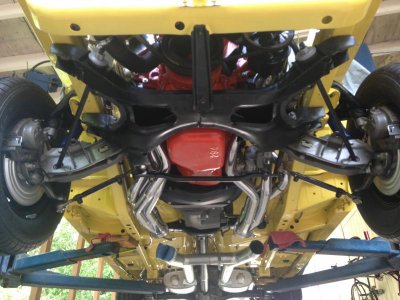

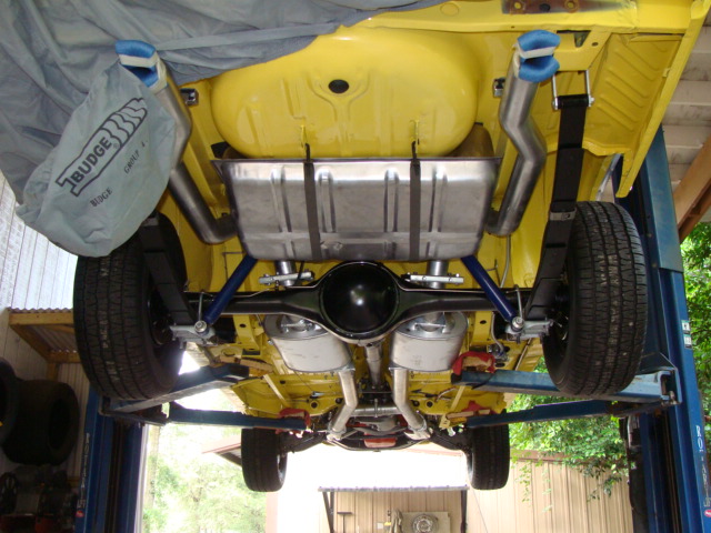

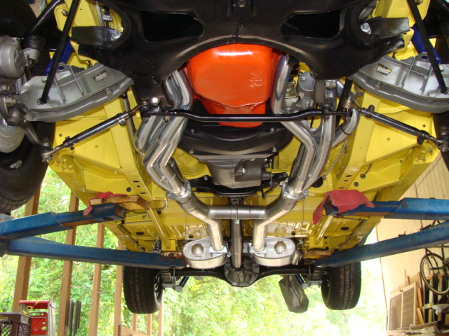

I would definitely go with TTI ceramic coated headers. I've installed them on my last two resto mod cars and love them. The fit is great and they look good for a long, long time. The first set I installed was in a 70 Challenger with a Herb McCandless built stroker 440 with Indy heads. The second was on my 340 Duster. Both cars have the complete TTI 3 inch mandrel bent systems complete out the back.
On A body cars the fit is real tight when you go to a 3 inch system. The fit was perfect all the way.

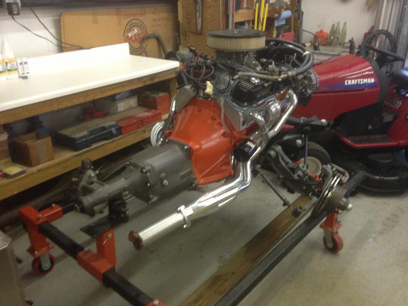

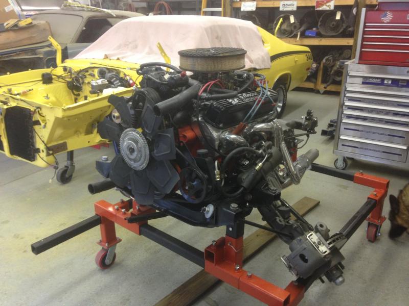

image.jpgHere are some pictures before the 340 was installed in my Duster. I try to install the engines from below if at all possible. It's a whole lot easier especially if your running headers.
