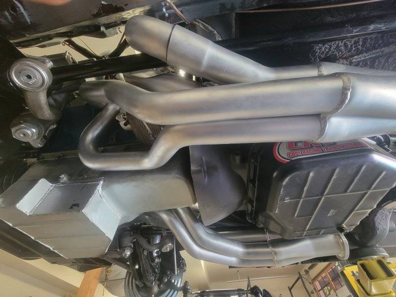

Can't speak about headers. Put a 3" TTI exhaust with H-pipe on my 65 Dodge fit fine. Didn't use TTI headers but needed extend cross over pipe.The H-pipe is 2 piece slip fit cross over.

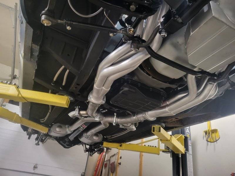

I’ve installed 2 3” TTI systems. The kit for my big block Cuda bolted in. I installed in my garage with the car on jack stands. Fitment was good.
The kit for my hemi Belvedere required some adjustment. I thought the exhaust pipes were too long and had to cut about 6” off each pipe to get where I liked it. But the cuts were simple. Otherwise, fitment was good. Again, I installed with the car on jack stands.
I didn’t like the narrow band clamps that come with the kits. I ordered wider clamps for the slip joints from Summit.
