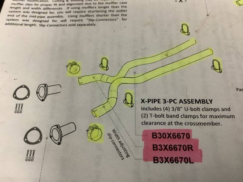

If you don’t use TTI headers then you need to fabricate a piece that goes between the header collector and the exhaust. It’s all on the TTI website
TTI has or had adapters that go between common headers and their exhaust. I used the adapters to connect the Hookers on my big block Cuda to the TTI exhaust.

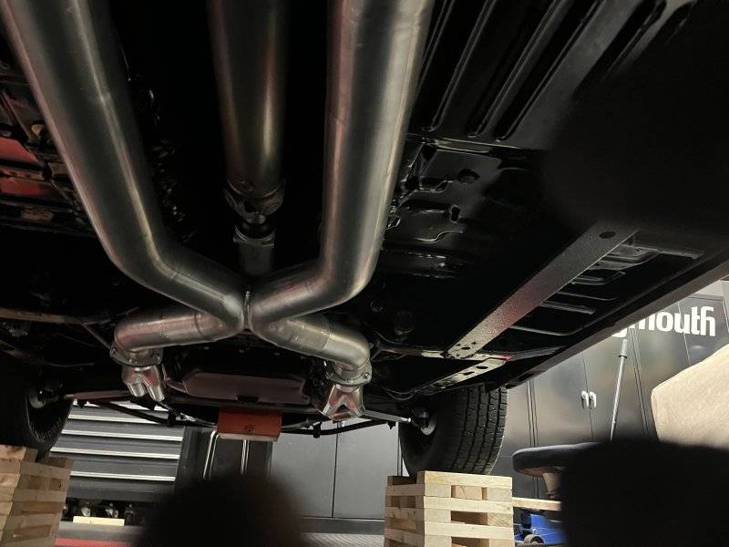

Next step will be to tack weld the slip connectors to the mufflers and the x pipe sections to each other so they can be removed and fully welded.
So the slip joints aren't permanent? Would you run the car with the slip joints unwelded?

You could leave a slip joint at inlet to mufflers easy to remove if you have to. Two ways a band clamp or a regular clamp. With a regular clamp put where you want and crush it some but not tight. Remove clamp drill a hole for a small 1/4" Hex head S/S sheet screw with anti seize. Then put clamp to cover screw.
Is the combination a true bolt in or is there still some fabrication involved? I need to replace the complete exhaust system on my GTX and the local guy that I know and trust isn’t set up to do 3”.
TTI stem to stern on a 360/904/8-3/4, center console shifted ‘67 Barracuda w/stock leaf springs and shock, the pipes are the X pipe style and the DynoMax mufflers that come in the kit box.
The only reason I had to cut the mid pipes is because the A body MoPars come in 2 wheel base lengths. The exhaust piping was an excellent fit.

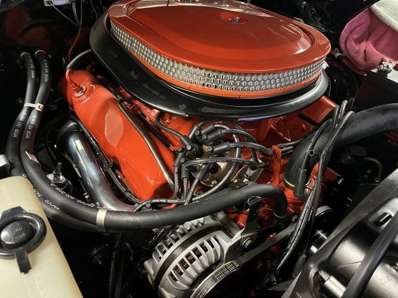

I did have to make one minor dent in the header to clear the manual steering box.
It sounds slightly deeper than the 2.5” system at idle, I won’t know how it sounds on the street for 4 months or so…
Overall I’m really pleased with the TTI products as well as the complete system. The fit was excellent and the sound level is just what I expected.
Here it is, fully warmed up. I’ve finally had the car out on the street, the x-pipe definitely has a different sound than an h-pipe and certainly louder than a 2 1/2” system. Overall I’m really happy with the end result…
Interior sound with the new exhaust system. There's some drone below 2000 rpm, fortunately with 4.10's it doesn't spend much time in that rpm range...
