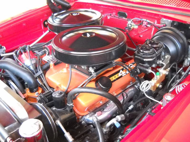

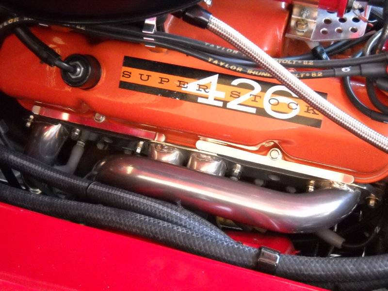

FYI: I sold my TTI headers and purchased a set of Doug's. Great fit and finish and easier plug access, especially on the passenger side. I know TTI is heralded as the king in Mopar circles, but I can't recommend Dougs enough; plus, they're several hundred dollars less. These are no light weights:
https://www.summitracing.com/parts/dou-d452-r/overview/year/1969/make/dodge/model/coronet

I got tired of burned plug boots. I used 8mm MSD, Moroso, Taylor and even tried Accel ceramic booted wires but continually had burn through at the boot or in the case of the Accels, the wire close to the boot. I pulled the headers and "clearanced" the tubes, but still occasionally would get the dreaded "miss".
I sold the TTIs and bought the Dougs, no hammering required, and haven't burned a boot or wire since. I run the Taylor Pro 8mm wire set which is very affordable compared to most other comparable sets. I can get a socket on all the plugs from the top except #6, which is easily accessed from the bottom. I'm very happy with the Dougs. BTW, both sets of headers are 2" tube and 3.5" collectors. The supposed loss of torque with the larger tubes is inconsequential with a full exhaust system on a street car.

Did you go with the ceramic ones? The pics look ceramic.

Great looking under hood picture. That's what they should look like.
