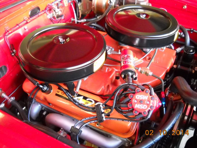

Colorado immaculate set up. I hear you about the wow factor and reliable manners you are getting. The 500 CFM carbs i bet have a great deal to do with it. bigger is not as reliable.
I had 750s on it and it ran OK but is much 'crisper' with the 500s. It's a street car and doesn't need 1500CFM. Thank you for the compliments everybody.
