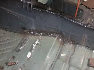

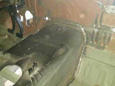

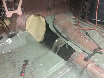

I cut my tunnel out . . .
Got a tunnel from a 2014 Challenger . . . and welded it into my car . . .
Mine is for a 6 speed - but a tunnel hump from a new car with the NAG-1 in it would get you the same result . . .

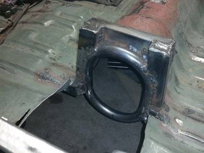

And while I was at it . . . I built a driveshaft loop into the setup . . .
very cool! In retrospect I could have done that and saved myself a bunch of time and welding.
