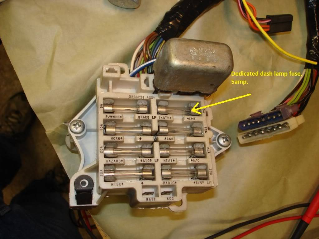

Under the dash, 3 of the 8 fuses light up on both sides but the other 5 don't. They all look like they have the metal piece across them but could they be burnt out?
With the remote starter I did turn the key and it just kept cranking and my spark tester read no spark. I think I bypasses the interlock bypass system. I'm thinking ignition switch, but I don't know how to test this?
Check both sides of the 5 dead fuses for 12V power...The INSIDE PRONG of ALL the fuse prongs on the fuse block should have 12V when the key is on..The outside should have continuing 12V power if the fuse/s are good....
here's a fuse box diagram....disregard the yellow writing and arrow...
alright ill check now
The 3 that lit up have 11.95V on both sides and the other 5 read no V on both sides. Does this mean the fuses are bad or they arent even getting any power? The fuses that work are the bottom 3 on the left side.
