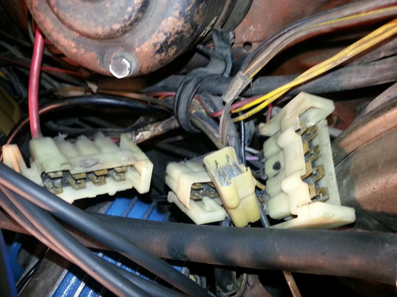

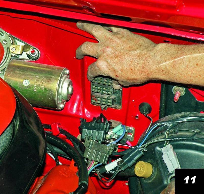

Ok, now to check the bulkhead connections, the bulkhead connector assembly is basically the other side of your fusebox inside the engine bay....The bulkhead connector on your car is directly under your windshield wiper motor..like the picture below, but not the exact picture of a roadrunner bulkhead connector...
You got to squeeze and pull the plastic sides of the connectors to get them apart...be careful because they are sometimes old/brittle and can break...
Once you separate the individual harness plugs from the bulkhead, Check the connections for burnt prongs...clean and reinstall the connectors

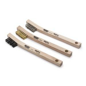

clean them with a small wire brush, you can get these at walmart, or most any hardware stores for a couple dollars...
then after you clean them, smear some dielectric grease in the connectors(available at most auto parts stores), dont be shy with the grease, use plenty...just put some grease on one of the wire brushes and smear it in the connectors...
