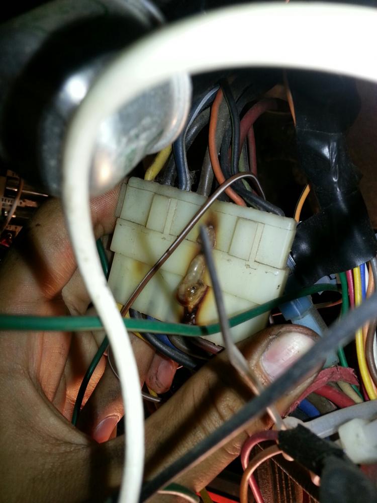

Yeah I see the white connecter. In the middle of it there is a part where it looks like it melted
ok, there is likely your problem...which wire looks melted in the connector..?...it's probably the red wire...
snap a picture of it for us if you can...
what about those 5 fuses in the fuse panel that won't light up with the test light?
yep, looks like the red one lol, if not the brown one will cause a no start issue also...
It's up to you now...you can bypass the burnt wire in the harness by cutting both sides off and splicing them together...personally i would bypass the entire harness since it has been damaged....
just be sure your electrical work done well, you dont want them wires to come loose under there and short more crap out lol...
BTW, that harness goes directly to your ignition switch...
the large red wire in that harness is a constant hot that feeds directly off the main hot wire going to your amp meter on the dash...
The big brown wire is the direct trigger wire that feeds the + side of your coil when you turn the key to the start position...

You still need to see if the burnt wire is still hot...test it first...and confirm which wire is burnt...

Okay the red wire is rewired now. Now what?
HEY!! My lights work again!
MY KEY TURNS OVER THE ENGINE! Now to see if I get a spark
