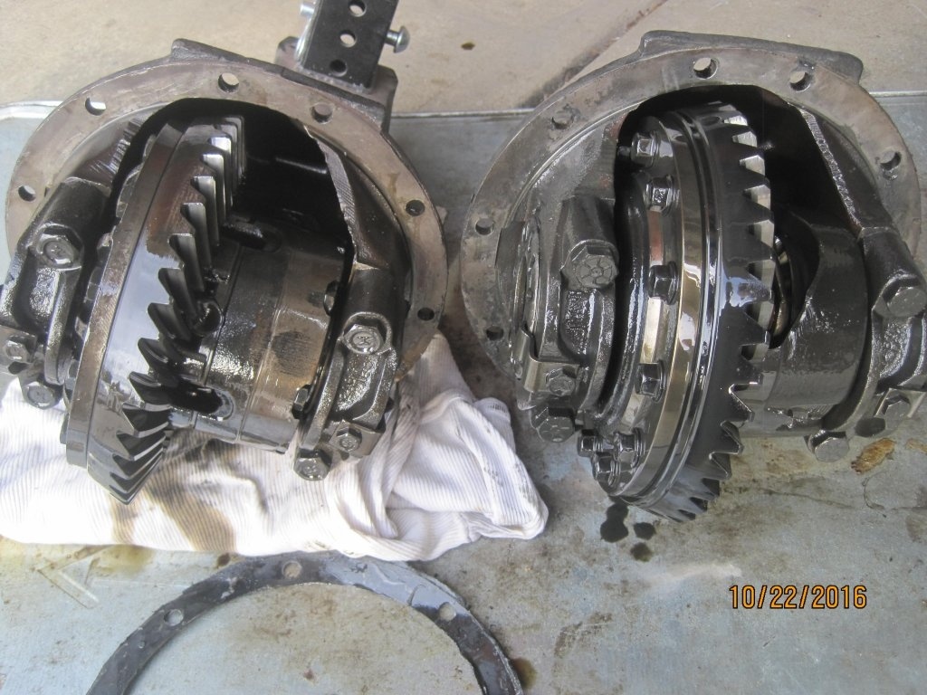

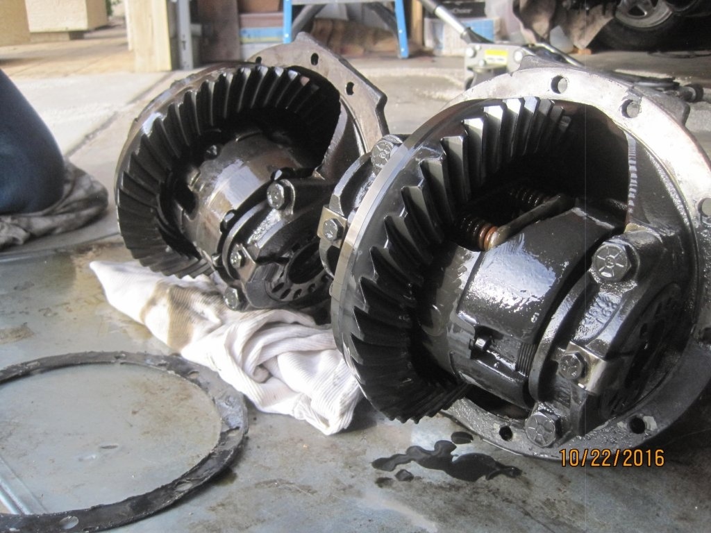

The pig on the right is from the Dart. There's obvious differences from the Coronet's. By looking at the pics can anyone tell if the Coronet pig is a SG? I turned one wheel and they both turned simultaneously, but now looking at it I'm having doubts.

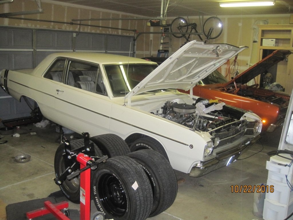

And thanks Devin (747Mopar) for talking me through the disassembly. IMG_3682.JPG
Can't see for sure, but looks like you have the two different styles of "limited slip". The one on the left looks to be the clutch style & the other the cone style. I always preferred the clutch style, they are easy to rebuild.

The left one is OEM and probably hasn't been cracked open in 47 years; might as well rebuild before slamming it in the Dart.

The one on the left is a factory Power Lock (clutch style) and the one on the right is an aftermarket limited slip unit but the brand escapes me right now. Are the axle splines the same between the two units?

The Dart LOVES the 4.11's. With the Tremec it still only turns about 2100 at 65 mph. I had the SG rebuilt, good thing too because the clutches were worn and a spider gear tooth was broken off - found it at the bottom of the housing.
