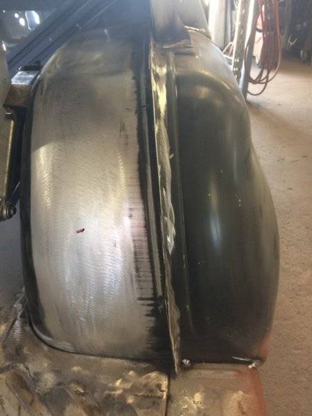

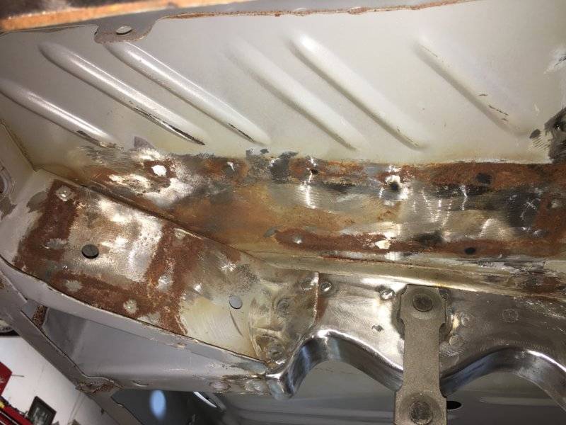

Start here. This is my thread. You might want to consider dehumping the outer half of the wheeltub also. I wish I had done it earlier in the process! If you have any questions feel free to send me a question.
I'm not replacing the quarter panels. So how do I dehump the outer half? Currently she's just a shell.

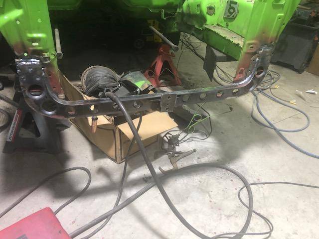

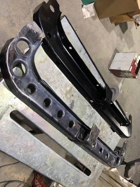

Lower Radiator Support 4.jpg Lower Radiator Support 5.jpg Lower Radiator Support 3.jpg
If you go far enough in the thread you'll see how I did it, pretty simple.

I'm running 315x60x15s M/Ts (which have a 11.75" tread width and 30" dia.) on 9" rims, did the spring relocation which is only 3/4'' on each side, and the dehump, Caltrac mono leafs, and 1" adjustable lowering blocks. Very close tire clearance but no rubbing, yet. And this kind and size M/T tire will make a metal B-body do 60' wheelies on a good dragstrip, if it has a big hp motor. But if your going for some hugemongus rear meats for looks, Right On Bro. You do what you want to your car, I did a lot of mods on mine... I saw someone on here that did the dehump with the quarter on, may have been 69gtx? You just do it from the inside, kinda tuff on the neck, unless it's in a rotis, which again I'm not sure I'd do. I did mine before quarters went on so it was easy from above, with car level... Sounds like your gonna have a really bitchin RR with a lot of good stuff on it. Keep us posted, more pics as you go.
