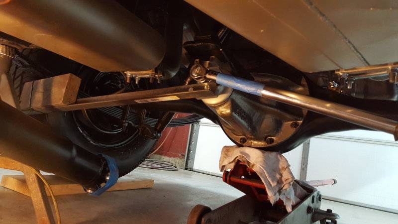

I didn't even mark the nut. After replacing the seal I used some Teflon paste on the splines and a little oil on the seal and contact area on the yoke. Installed the yoke, washer and nut. Tighten till it bottomed out and turned the yoke to seat the bearings. (Maybe didn't need to do that part) A couple of nuts/washers on the brake drums and applied the E-brake. Tightened the nut as far as I could underneath and then moved to the pipe on the breaker bar. Like I stated before I had the bar sticking out under the leaf springs so I could stand on it. Stood on it till I couldn't move it anymore.
The pipe wrench is one way to help hold the yoke, I actually used a 2' piece of angle iron with holes drilled to bolt to the yoke.
If you're raising the car maybe try placing the pipe wrench in a different position where it has a different outcome.
