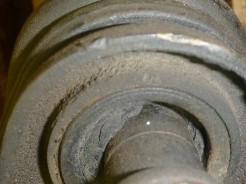

My lower control arm bushings looked OK until I pulled the arms out! Wow, the bushings were trashed.
Mike
Like these Mike...
I don't ever think to take pictures like that. I put new lower control arm bushings in 3 pairs last week. I have 2 more sets without sway bar tabs that need doing, but when the hotchkis tabs come in, I will tackle those and add the tabs. Also installed one of the 3 sets on one of my GTX'S.

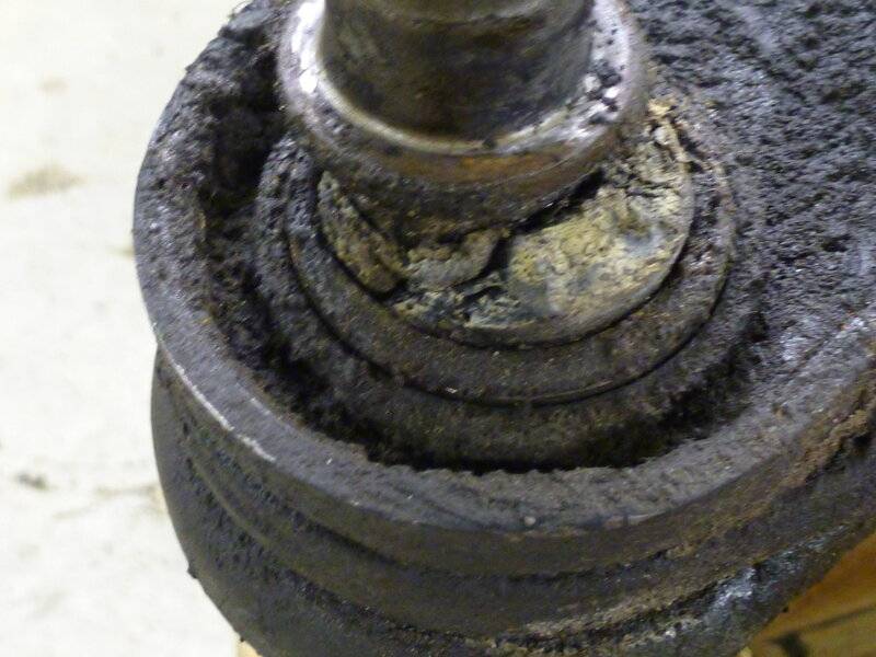

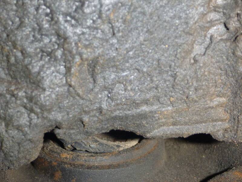

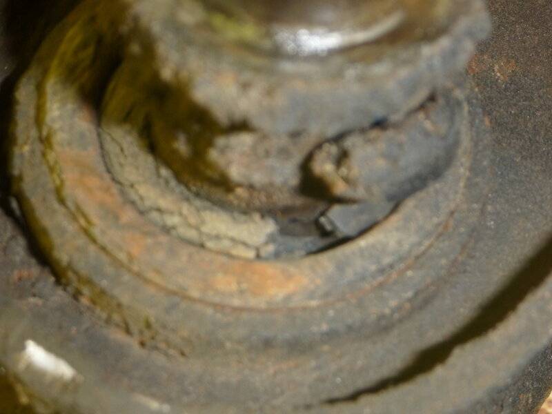

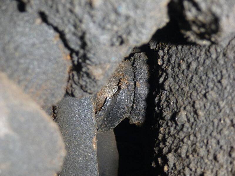

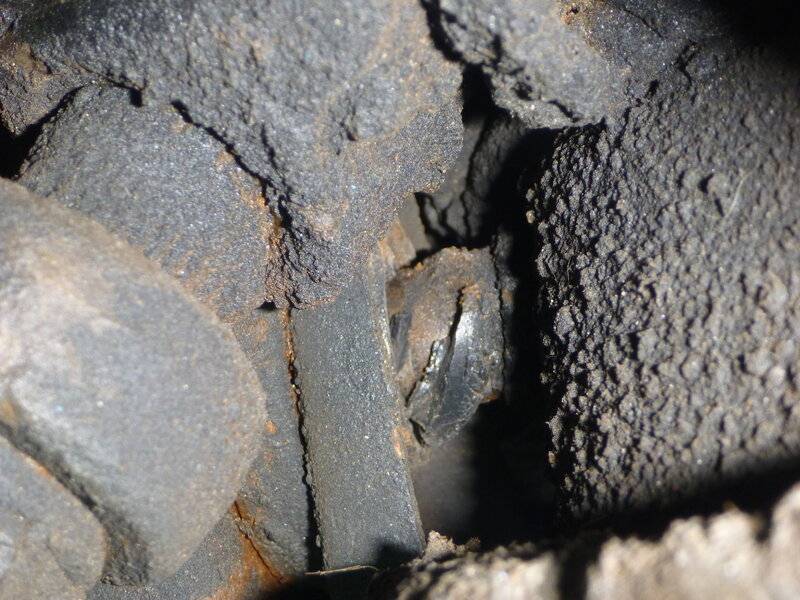

You can certainly inspect the LCA pivot bushing installed enough to know they aren't centered anymore or the rubber is deteriorated...

What I could see of the LCA bushing they actually looked pretty good - but I'm not confident I could see enough to really evalutate them. From the ball joints and tie rod ends appearance I'm going to plan to rebuild the front end sometime this year.
