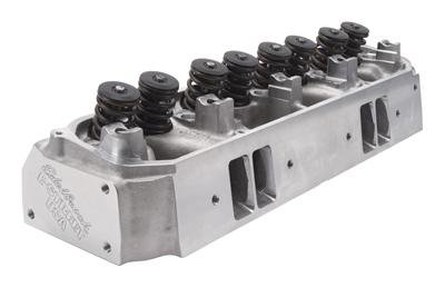

Cr8crshr if the heads are wiped out, try the Edelbrock E-Street Aluminum Cylinder heads, 210 cc intake runners, 75 cc Chambers, 2.14" intakes & 1.81" exhaust valves from Summit Racing for $979.95, will ship tommorrow, if you needed them, they would be a perfect head for your intended use & 383ci combo, they are a better head, than the stock cast iron heads in several different ways {in my opinion anyway}, they are lighter, they flow way better, will run cooler, they have blind exhaust bolt holes {not into the water jackets}, they have larger valves, better valve springs, retainers, seals, hardened seats & better locks, they have many advantages over stock cast iron low performance cylinder heads, the weight saving alone will improve performance & handling, Edelbrocks are an American made American owned company, the heads are 100% American made, machined & assembled here, also have American made quality parts, already installed, if you have & are willing to spend the extra funds of course... Any heads should be checked out & cleaned at a minimum, no matter WHO you get them from... If your going to spend the extra money, do it right the 1st time, or 3rd time now {sorry I couldn't resist, no offense intended}, if you wanted Aluminum heads or were thinking about them, now is the time, instead of wasting money, on an old wore out inferrior part, you've waited this long already, a little longer won't or shouldn't be a real big deal... The cast iron heads you have, can be made to work, but if you have to spend a bunch more $$$$$$$$ on them, just add the extra money & get the E-Streets, it will be money well spent.... Just my $0.02 cents, I'm really good at spending other peoples money...LOL... I wish you all the best in what ever you choose to do, Good Luck buddy....
PS, if you go the route of the aluminum heads, who's ever brand, you choose, you will need to buy ARP Head bolts & hardened washers, to install & torque them properly, they are like another $60, also get a head gasket that is designed to go on, an iron block with aluminum heads, Fel-Pro or Commetic both have decent choices, another $40... Your excessive valve train noise, you mention that something didn't sound right, it could be, worn rocker shafts & rockers &/or the wrong length push rods & improper lifter pre-load, if you change the heads or when reinstalling the heads, check the length for the proper type/style/length push-rods, performance cam types will vary in base circle & if the heads were shaved or the block was decked or the valve ground to dfferent lengths, push-rod length will possibly need to be change... Smith Brothers Push-Rods is a very good choice @ a reasonable price, with great quality & service.... Hang in there buddy... This hobby always seem to cost a ton of $$$$ , especially if you want to do it 100% correct & have it last.....

Budnicks I only use ARP Bolts and Fasteners on my engines so I am good to go there. I will also go with the Cometric style head gasket in place of the FelPro or MOPAR thin head gaskets. I plan on doing my upgrade purchases through Hughes Engines as I have their cam and lifters already. That way they can get the heads set up to match the Cam specs. Done business with them in the past and if you follow Dave's recommendations and suggestions, their stuff comes out working as advertised. Just got to start saving the $$$$'s for them. And with being retired and on somewhat a "Fixed Income" it will take a month or 2 to gather it up. There is still tons of little stuff I can do in the meantime one of which is to change the rear gears from 3.91's to 3.55's....
