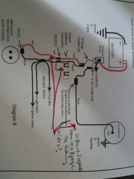

Yes in retrospect that is what i was thinking too. So I think if you look at the diagram i posted it would be best to just upgrade the black wire from the alternator to the starter relay and the wire from the starter relay to the battery. I could go 8 gauge with a 12 gauge fusible link. Car is mostly stock batery in original location.

1.So Nacho you make some good points. I think I will go to an 8 gauge wire from the alt. to the starter relay and from there to the battery. Given this don't I need to go with a #12 fusable link? If I dont then will there be any benefit in going to the heavy wire, #8. I certainly don't want to make it where if I do have an issue it cause some thing to burn up and go poof!

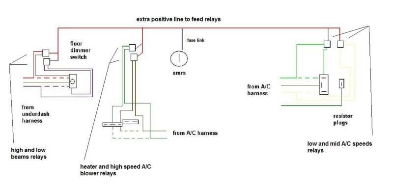

Yes I used a 6 relay setup on my car all spreaded around into the cab and being sourced from the ammeter stud, alt side. These relays are low and high beams, low, mid and high AC blower speeds and Heater speed ( which is diff from the AC speeds ). Installed light relaus into the kick panel area, heater and high speeds around steering column area and low and mid speeds just over the AC box. Making this distribution what gets saves is the harness itself from being cut, but just removing the terminals from original plugs and using a jumper wire ( same color than the one installed ) to replace the one being removed. This make the relay upgrade invisible. Will search the pics and post
This the basic diagram what I can get deep into it if required:
The deal is save the heat from blower speed switch ( their contacts are poor ) because on 73/74 this piece allways get heated able to melt the plug. Can't tell if is the same situation with 71/72s since switch on these is different. I'm searching the pic of how it looks the harness and the relays being hidded.

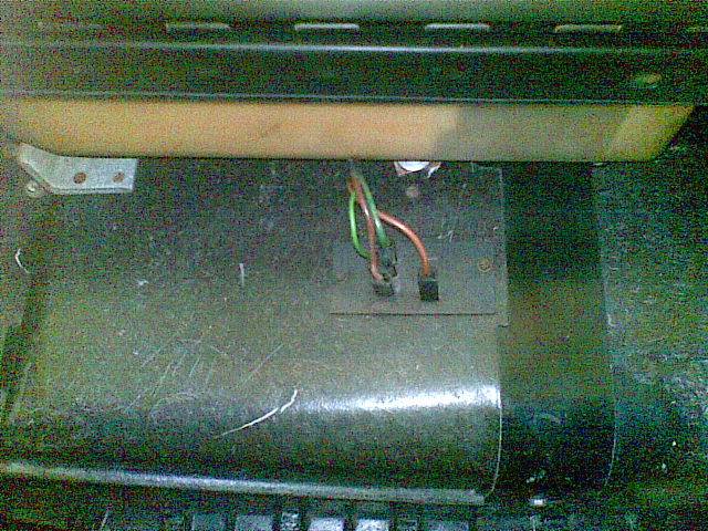

pic one... how it looks the A/C harness, totally stock, uncut, same colors.

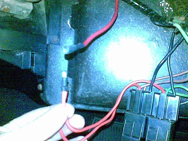

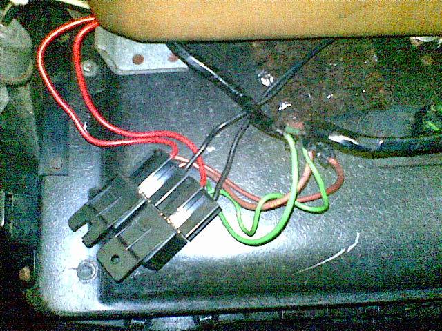

pic two... I pull out the harness abit and relays appear.
pic three... I run the 12 gauge red wire taking the power from amm. Used bullet kind terminals on each location to splice the power for each pair of relays. If I need another relay around, just cut the male end, add another wire for the new relay and attach a new male bullet end.
Relays are held up by the AC box bracket nut on firewall, same as the ground for them.

The reason why the relay setup is spreaded in that way is because the max AC speed doesn't come from resistor box but straight from blower switch, so I decided to balance the load for the red wire feed all around making just ONE relay will be activated at the same time on each red end for the relays.
There is one exception on this, and is the blower low speed is BY DEFAULT allways ON as soon you turn on the AC. You can unplug the speed lever switch and the blower low speed will keep sourced ( at least on 73 and lates ) with just turn on the AC. This doesn't really matter selecting mid and high speed because by OHMs LAW the load will go throught the less resistance available. So you can select the mid speed and both relays on AC box area will be activated but actually just one of them getting the load to feed the blower with mid speed
