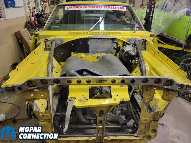

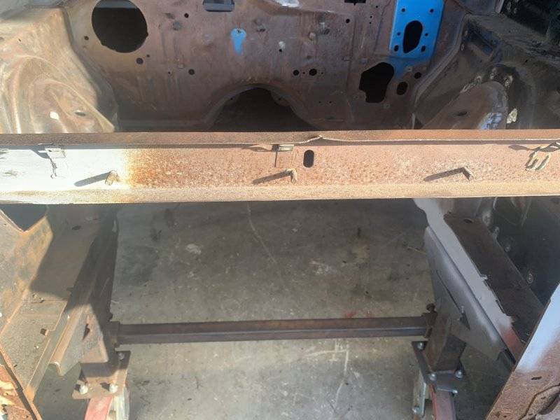

Anyone know what attaches to these three studs on the core support of a 1970 Charger ? Bought a core support stiffening kit and it’s going to block them.
the hood latch support, attaches to the lower also
you have a stiffener for the upper?, I've only seen the lowers
Does that lower core support stiffener even do anything? I question it because of how close the front of the K frame is to the front of rail and all that looks pretty stout.
I thought the same thing
It helps the lower support from deforming when some dumbass decides to hook a chain to it and pull it because they're too lazy to hook to the kframe.
I see that- but if I were in business to sell stuff would be making everything possible. I saw a pic somewhere of someone B body going thru a turn, front inside wheel IN THE AIR, no core support stiffener and the hood/fender gaps were spot on.
Core support stiffening is just a part I wonder about, cost-benefit thing I guess. On top of added weight etc.
I did the lower core support stiffener on mine and it sure seems like it helped a lot. I can pick up the front of the car by it now with no issue at all. The factory piece isn't adding any useful support at all and IMO there is nothing stout at all with the way these cars were built.
