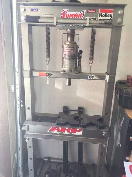

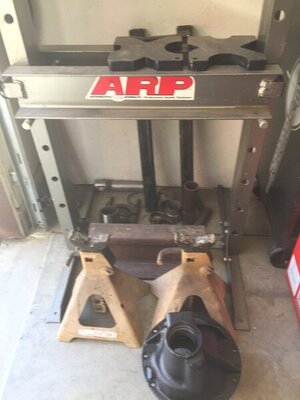

20T press from HF works!! I have one and 2 of my buddies have it also. You’ll be happy with it. I’ve done lca uca bushings, sure grip bearings, axle bearings and leaf spring bushings. Damn thing works great!!!
I have had the 12 ton for a few years and it does pretty much every thing I need. I do find its a little short for some stuff like dealing with axles and I have to block it up some. If I were to buy again I would go 20 ton.
I have the 20 ton model from Hazard Freight and it works fine for me. Don't think I would go any smaller.

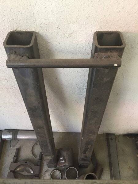

20 ton will do everything you need. maybe make some side money doing press work for people. you might want to get 2 hyd. jacks for when the first china junk dies. that will happen right in the middle of a job. your also gonna need press tools. I have a selection of old bearing races and misc round pins and flat plates for any given job. It all looks like junk to the untrained eye but I can press just about anything.
