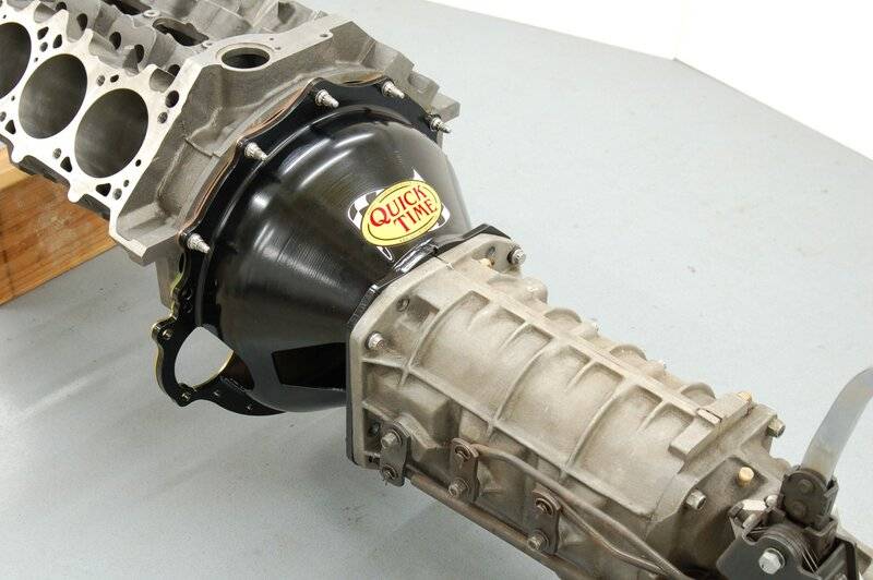

Using studs for bellhousing to block mounting
Here is another picture where I used studs with a scattershield. The ARP studs are the best ones to use for this type of application.
Yes, the bullet nose is a nice feature. You can also use studs with the broached hex in the end since those are easier to install and remove but I prefer the SST ones since they rust over time.
