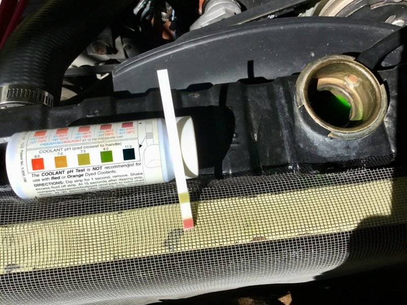

View attachment 801297 Thanks for the reminder. I think these colors are in-range.

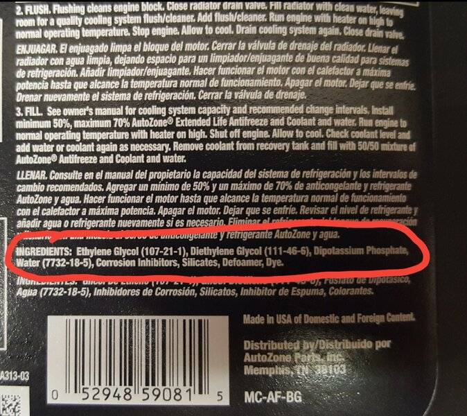

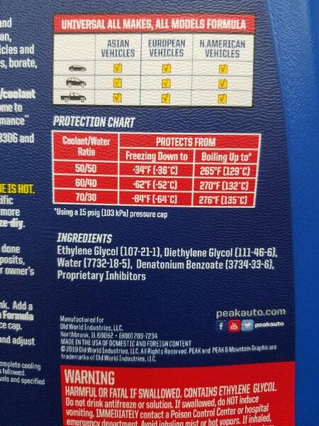

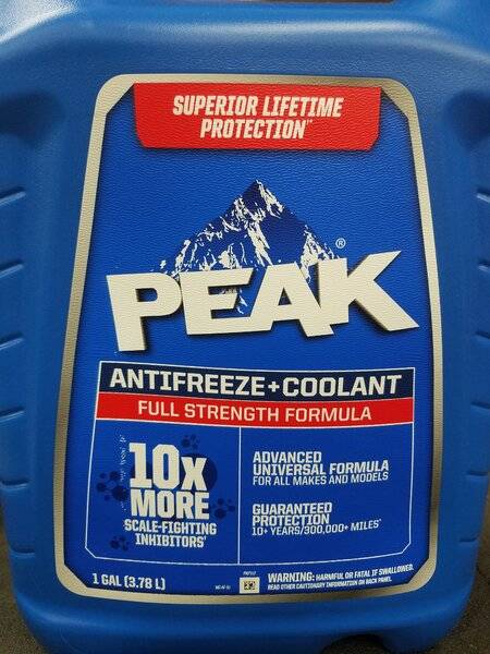

I wouldn't mix. The color is an indicator of the corrosion inhibitor type. We know for sure you can't mix with NOAT so any claim that it can mix with anything sounds like BS.What is you guys opinion on this Peak product that claims it can be mixed with any color coolant? It is yellow and missing the diptassium phosphate that is in the green stuff.
View attachment 983478 View attachment 983479
