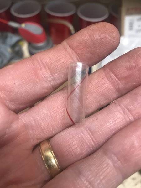

Can somebody tell me what this is for? Came with the valve seals.
View attachment 654275 Can somebody tell me what this is for? Came with the valve seals.

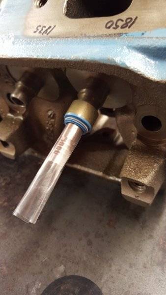

Slide that over the valve stem, then slide the seal over that, then remove. Keeps the seal from getting cut by the sharp valve stem tip.
I made my own.

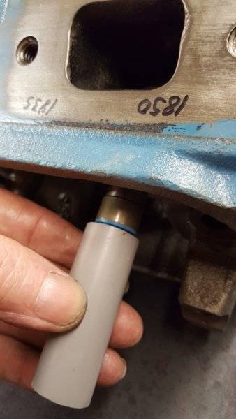

I also cut a piece of 1/2 plastic pipe to tap the positive seals on if you're useing this type.
