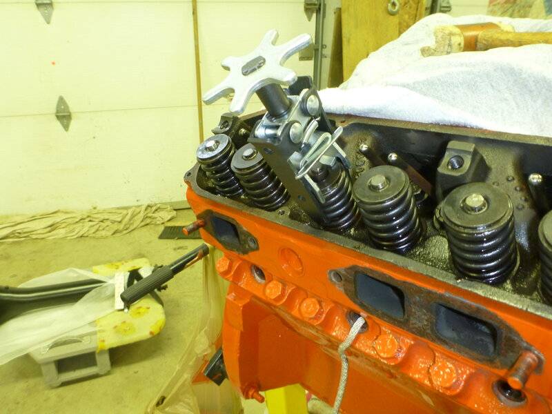

I've removed valve springs with the piston down in the hole before. You can always slide a piece of hose on both halves of a set of needle nose vice grips to hold the valve stem if you're scared.

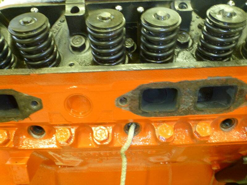

Feed a good length of rope into the hole and bring the piston up and forget about using air is another alternative.
If you put the piston at TDC, it will stay there
Use a length of thin rope (1/4" or so) thru the spark plug hole, and move the piston up as far as it will go (firing stroke); that will hold the valves up.

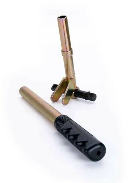

What are you using to compress the spring? Are yo using a proper spring compressor like Dadsbee pic he posted?
