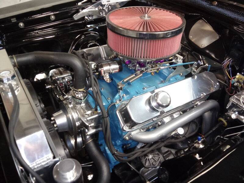

I've got what seems to be a basically stock 1972 440 in my 68 charger with a 727 trans. The 440's history was unknown to me but after compression check, etc, I concluded the motor was good enough for me for now. But, It has a problem and starts missing at about 4300 rpm. I can make it do it in neutral/park while sitting still. It will go dead unless I pump the throttle and then it will recover after about 5 secs. It feels and sounds like some cylinders are not hitting/firing. The motor makes no noise such as valve train rattle, etc. I have a new proform distributor with electronic ignition on it, which I'm not sure to be suspicious of it or not. Somehow I got the idea that it could be floating valves and a bud agreed after I demonstrated it for him. The motor runs like a dream until I shift it myself and let the rpm get to hi, then it is almost like turning off the key except I can hear and feel it not hitting on all 8. I instantly let off the gas. As I coast down I pump the throttle to keep it alive then it recovers and comes back on all 8. Could the valve springs be old and weak and causing the valves to float? Does this seem like valve floating? I'm thinking about buying some new springs just to see if that's it.. Any info appreciated..

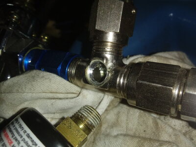

I'm running a fuel cell with big new inline filter. But I agree from what I remember, it shouldn't go dead from valve floating... Here is a pic of something else I am looking at as possible cause of fuel starvation at upper rpms. I have a fuel gauge on the side of the T fitting at the carb dual feed line fork. When I installed the gauge I thought it might be going in too far and blocking flow. It appears to go about 1/3 the way across that inlet hole when threaded all the way in. But I did get a bud to watch the gauge while I revved and stalled it. He said the gauge never moved from where it should be. So that kinda rules that out.

Does anyone think it could be the way I have my plug wires twirled around and wadded together? These are comp cam wires with the extra nylon sleeve/cover. Thought I read somewhere that it's good to spiral them around each other like this, can't remember why.. Also I did look at the float levels. The carb is a brawler/holley 750 and has glass windows. The front bowl level is at the top of the window and the rear is nearer to the bottom of the window. Do I need to raise that rear one a little?
Sounds like that would be the worse way to route the wires. When they are running parallel to each other the current is flowing in the same direction. This will just make it easier for any ignition leaks to jump to the closet wire and cause misfires. They should be separated . Lifter pump up can be eliminated on an adjustable rocker system. If you have adjustable rockers, they are set too tight, but that is not what you are describing. Sounds ignition related. High rpms demand more voltage to the plugs to fire. Incorrect plug gap can also contribute. You may have several problems. Did this just start to happen out of the blue ?? Or did it start happening after a part change or modification ?

Just because you have fuel pressure doesnt mean you have sufficient flow. I think you answered your own question. "Pumping the accelerator keeps it running". In this case it's out of fuel. The only fuel is from pump shot until the bowl refills. " The fuel gauge blocks 1/3 of the line". That's not helping flow. Remove the lines at the carb itself. You haven't mentioned what type of fuel pump. Crank engine or turn the pump on. Measure the amount of fuel pumped in 30 seconds. At 300hp you need about 1/4 - 1/3 of a gallon minimum. You also need a a proper vent in the tank. Dont forget the carb. If there is a screen in the inlet or the float level is very low that will be an issue. To me valvlve float would act as Dwayne has said. Ignition would more than likely misfire.
