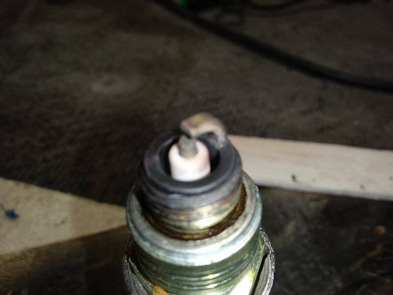

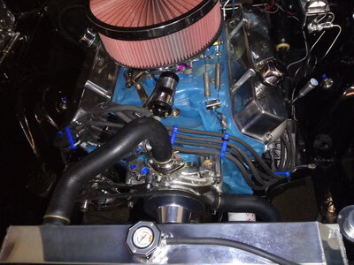

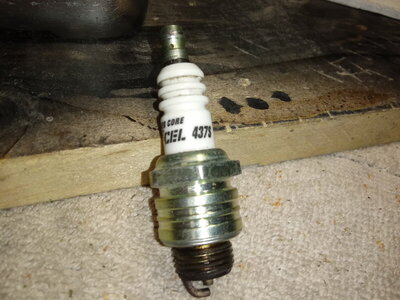

Here's a look at a plug. Looks good to me. They are Accel 437s plugs, set at .035.. I'm thinking it's not the plug wires or it would backfire, carb pop, and recover almost as soon as I let off.

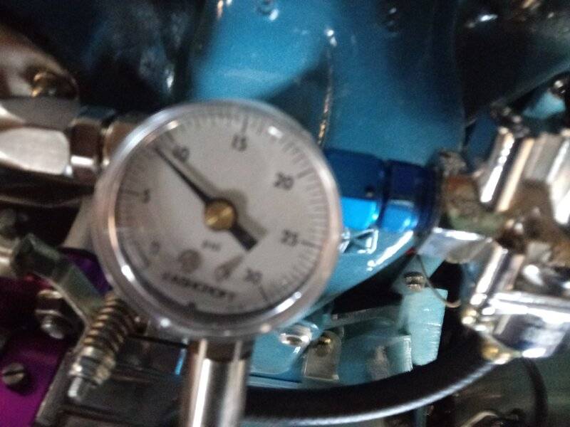

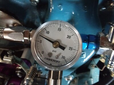

I raised the rear float level a tad, no change. I noticed the fuel pressure at almost 9 before cranking and a little over 7 when idling. I think that's ok.. What would be the symptoms if the carb jets are to small or lean?

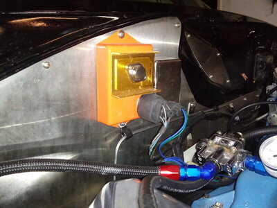

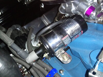

Would the motor go dead?... I rerouted the plug wires and spaced them apart from each other and now they're not really touching anything, test run with no change.. I'm running an msd blaster coil with a proform electronic distributor/ignition and wondering if those are ok with each other? I think I made sure they were compatible when I bought them.

It is a proform electronic conversion kit from summit. It came with distributor and module.

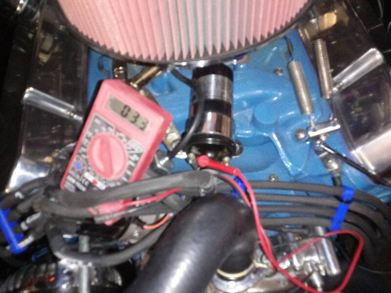

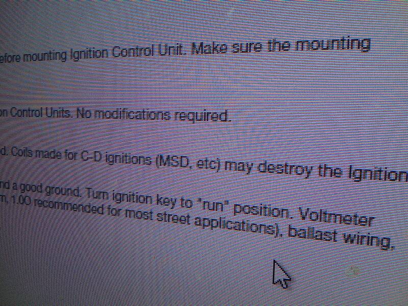

I may be on to something that doesn't add up. I read where the voltage from the +pos side of the coil should have 7-9 volts with key in run position. I'm getting 3.3 ., What's going on there?. And I read that msd coils may ruin the ign module., What's up with that?... Anyway thought I'd start throwing money at it till it's happy. Looking at a hi-rev module and a suggested coil from jegs. If they don't cure it I'll have some good to have spares.

Sounds like you need to start probing the power wire at various points between the firewall connector and the coil.
I had a similar situation in my car many moons ago when I was still running an OE style box.
I only had 3v at the coil....... but I also only had about 9v at the hot side of the ballast resistor, and about 11v at the firewall connector.
The old factory wiring was all green inside and was one big resistor.
I’d had an MSD 6A box on the shelf for a while, and that was the motivation I needed to install it.
The main power wires go directly to the battery, so you bypass all the factory wiring to power the box.
When I’d discovered the 3v at the coil, it was after I had put the 340 in the car, which revved quite bit higher than the 440 did.
The problem revealed itself as a high rpm intermittent miss.
I had swapped coils when I put the 340 in........ to an MSD Blaster 2.
When I discovered the miss, I reinstalled the old coil, which was one of the big yellow Accell super coils.
The miss was still there, but maybe slightly less.
Once I tested the voltages, I knew what the problem was.

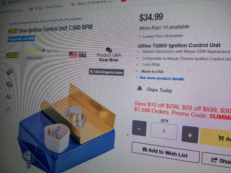

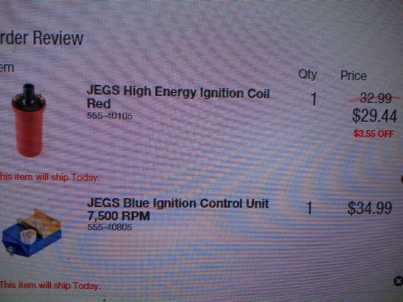

I questioned that ECU Ignition Module
Yes , the MSD Blaster 2 coils are intended for CD type ignition systems
Hence the low Primary resistance of the coil itself .7 ohms
Your on the right track with that Ignition Module from Jegs (Rick E)
And proper 1.5 ohm primary resistance coil

Low voltage at the coil & what looks like a real low RPM box, combined with corroded or bad wiring may be the issue? Coils do need to match the ignition controller/box. CD coils don't mix with lower perf boxes.
I have no problem believing a Proform box running the wrong type of coil is causing some issues......... but......
When I had the 3 volts at the coil(car running/charging), I was only seeing a very slight intermittent miss when the revs got over 6500 going down the track.
Nothing even close to the OP’s description of the motor basically shutting off.
While I do agree there are some ignition issues that really should be addressed...... I’m not totally convinced this is the root cause of the “dead at 4300” issue.

Does the ign module/box need to be grounded to the car/frame? A bud said yes and now I wonder if that's true if my stainless firewall panel is not letting it ground good. I put foam seal strips under the ss to waterproof in between the it and the original firewall , ss screws holding it on also. Does stainless conduct/ground ok for this situation?
