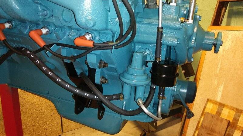

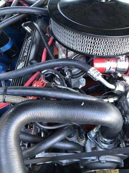

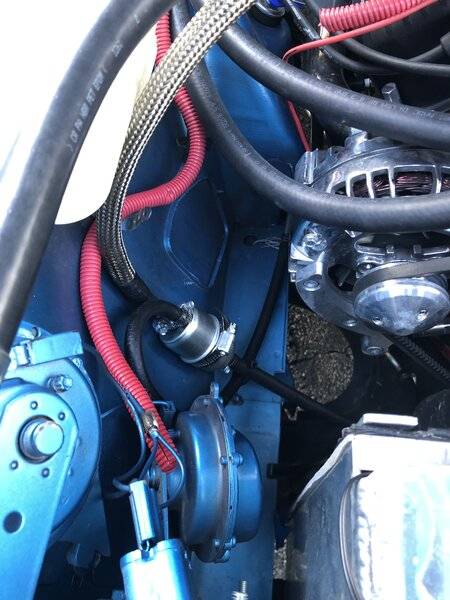

Just went thru this on our 440 build. Boiling gas, lean out and then getting hot in traffic. You will need the vapor separator, return fuel line, and second nipple on the sender. Wix makes the seperator, but you will need to reduce the orifice size to .060” on the return leg. I used a brass screw, turned it down to fit inside the 1/4” return side and drilled the hole. There are prebent 1/4” return lines from Mancini. If your sender does not have a return, I read that some tap the filler neck.
748EFC47-C3EF-4048-8DE4-EE94B57B7B1A.jpeg 1C7315E6-3B12-400C-92BB-1B66F71193D5.jpeg C253A373-2F95-4222-8B19-5E1722E3AD6D.jpeg

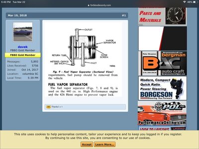

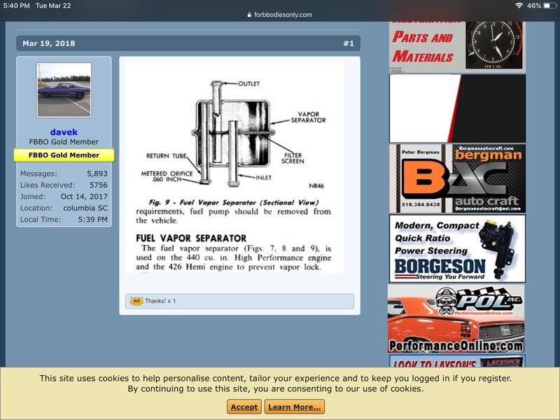

440 Six Pac cars had the 3/8" fuel line with a 1/4" return and the vapor separator for a reason. You just found it.
I went through the same thing with my last two stock GTXs, a 440 4bbl, and my Hemi. The return line was in place, hooking up a factory style separator cured the problem.
