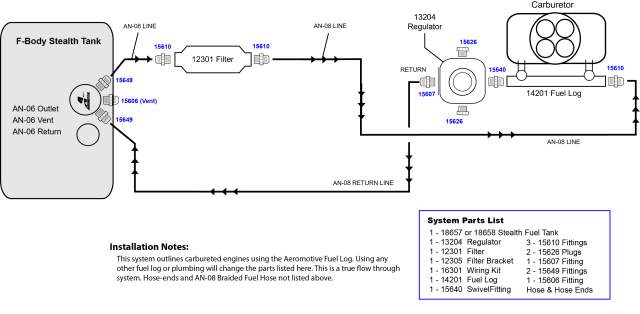

Your plumbing should essentially like this:
You can see the regulator is used as the restrictor for the fuel return. This is the proper way to set up your fuel system. This assures a constant supply of clean, cool fuel to the carburetor. Except for cold starting, driveability will approcah fuel injected systems when set up in this fashion. Good luck.
