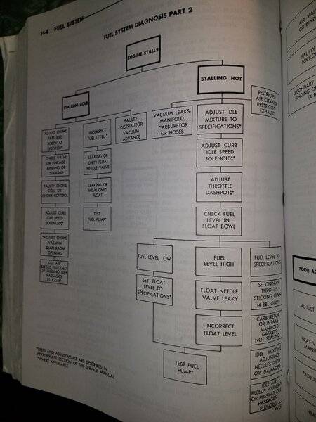

Ok thanks - It’s at about 840-890 rpm nowAnother problem I had was adjustment - ultimately the curb idle was too low.
Hook up a vacuum gauge, then observe the symptom.
That tells me nothing. What is vacuum at start-up? What is vacuum at idle ? What is vacuum at part-throttle ? What is vacuum when throttle opened-up ? What is vacuum when put in gear ? What are the gauge readings and what is the needle doing at the moments I mentioned ??????Have had the vacuum gauge on it been trying to find vacuum related issue so far no luck

16 lbs min on idle - steadyIs the vacuum steady and how much?
Thanks ! We tried a 2nd different coil and … fixed !A bad ECU can fail once the engine warms up.
Hey thanks ! tried not 1 but 2 different coils and with the 2nd one we tried on it is now fixed !Check coil
