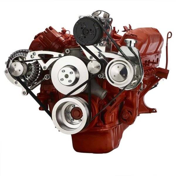

I’ve been talking with CVF, and I think the Beast system will allow me to keep the clutch fan. Probably going to go ahead with that one on black. Hope there is enough room!!!
Here's the maxed out Beast, with AC, PS, WP, and ALT

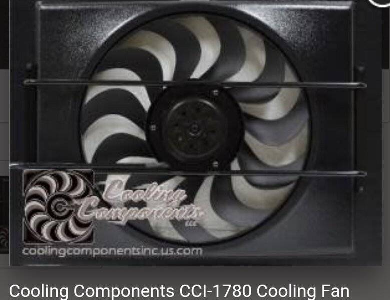

I am going with a fan and shroud assembly my vendor recommended.
With only 3" of space, I was limited, but he recommended this one regardless.
The Wraptor/Max Performance dual 12" fans and shroud assembly is 3½" deep, so no go.
So, you don’t think I’ll be able to use my clutch fan?
With the Beast, I really don't know. I changed out the radiator AND I'm using a different pulley system.
I'd put it all together and see, but be prepared to have to use a different fan.
