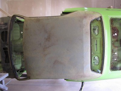

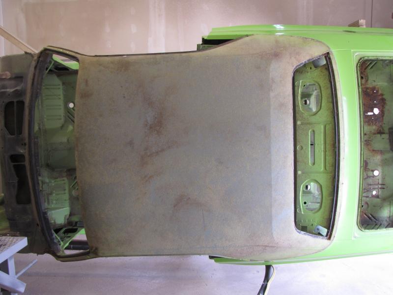

My original vinyl top was a shredded, dried up mess, so I tore it off. Then I went to work with gasket remover spray (worked ok) and Goof Off (worked even better, too bad I only had a 4 oz. can) to get rid of the glue on the roof. Thought I'd check with you guys - could you recommend a nasty chemical that would help me get rid of that dried up glue?
(Btw - Mama Mopar's boys in 1968 didn't waste a lot of that precious FF-1 paint, it seems... paint was sprayed on really thin underneath the vinyl - primer was showing through in places. That does explain the rust issues often experienced underneath vinyl tops...)

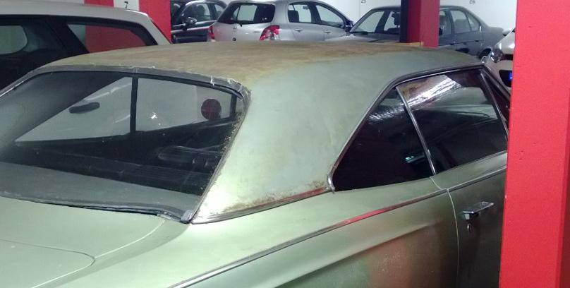

Tried a generic glue/sticker remover laced with acetone - gunk peeled off sail panel and roof edge with very little effort:
