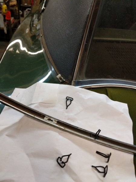

Hey guys,, I bought the clips but here is what was on my car that needs replacing. I can't find these plastic pieces anywhere.. What is the history? I think I like the plastic solution better as the holes are smaller and they are plugged?
But what is the best solution here as I have yet to find the plastic clips, any idea where they are? Thanks for the help. Jay
Hey guys,, I bought the clips but here is what was on my car that needs replacing. I can't find these plastic pieces anywhere.. What is the history? I think I like the plastic solution better as the holes are smaller and they are plugged? View attachment 579332 But what is the best solution here as I have yet to find the plastic clips, any idea where they are? Thanks for the help. Jay
My car did not come with a vinyl top. I bought that trim from e-bay, and it did not have the clips with it. I have never seen the plastic ones like yours show. I will paint around the holes and use black dumdum sealer around the wire clips to seal the hole. I would be interested in seeing what other members have used............MO
