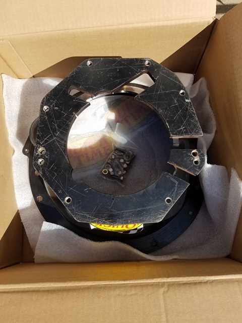

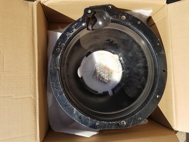

I have found an used bellhousing on facebook and I don't know what to think of it. Apparently it is new but the scratch on it looks bad. What do you think of it ?
Nobody ?
Scratches don't phase me, these things are pretty beefy so I'd just make sure no holes are egged out and check the runout as recommended by Quicktime (can probably download a pdf file if missing the directions). I wish I could help you more but all of my research was related to BB's, the bellhousing I bought dictated which flywheel to buy which intern dictated which clutch setups would work. If I remember correctly it's a GM clutch??
