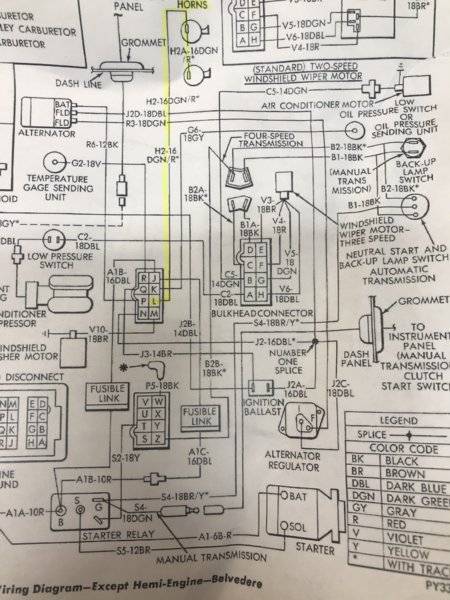

I am installing a new MSD distributor ready to run in my 70 Belvedere with a 440. I have removed the electronic ignition, ballast, etc. and just have a standard points wiring set up (as pictured). However I am getting 13.4 V at the coil when the engine is running, and 11.8 when the engine is off but in the run position. Doesn’t that mean the voltage regulator is bad? The engine has never ran better, but I want to confirm that voltage before driving it.
The voltage the alternator puts out can go up to 14.5 volts or thereabouts.
It depends on what is drawing current and the state of charge in the battery.
So any voltage under 14 or so won’t hurt the coil?
Correct the coil will not be worried by an extra volt or 2.
If the regulator is faulty and over charges the battery that can be no good but from info in your post I believe you are ok.
All mine have hit in the 13’s while running. I’d say your good
