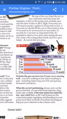

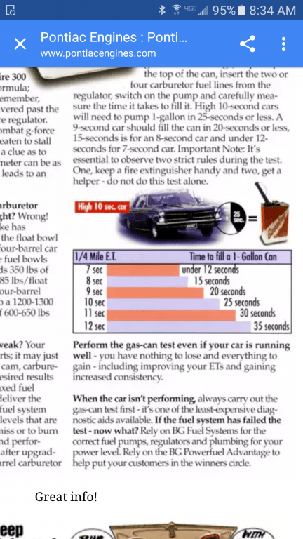

Tested after the regulator.
Never tested how much I actually use per run but its about a gallon. This is one example of the test that I did.
Going back out in the garage now and put the old "impeller " back in.
This seems to have started after I installed the "updated" one.
I also need to check the gauge on my pump. I have the pressure cranked all the way up now and its only showing 13lbs.
Looks like your with-in that spec in the photo you listed,
just seems low to me...

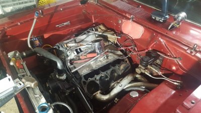

Cylinder #1 175 psi
Cylinder #3 50psi
