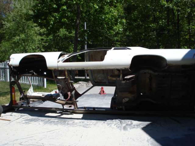

Sandblasting May 2015 004.JPG here is one I made I will see if i can get a better picture

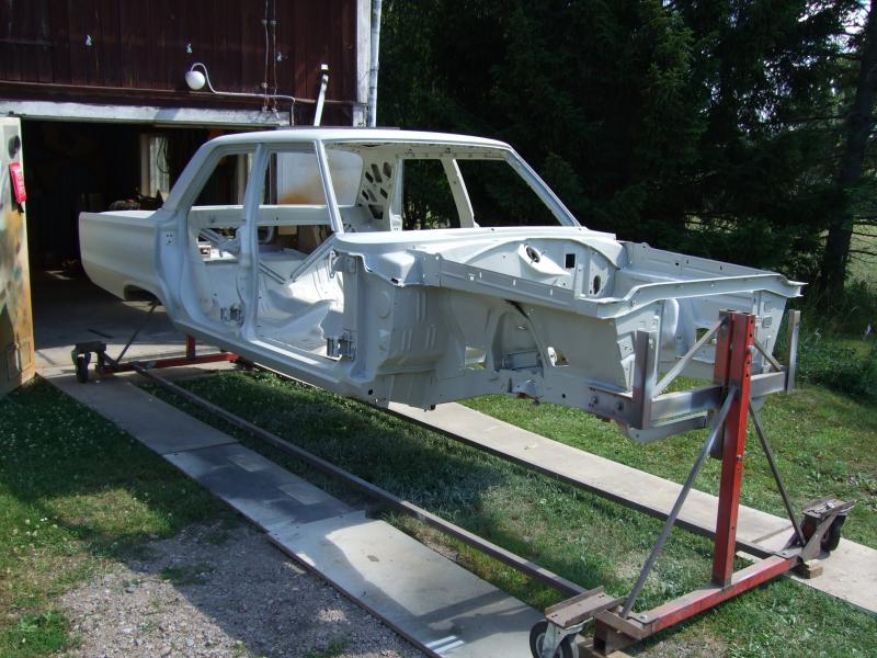

I've built 6 of them so far for myself and 3 other people. Look here www.drblast.com and there's tons of pics there of my projects and many of the pictures have the Rotisseries in them. Also, here on this website fbbo look for my posts I've started, like my GTX and Satellite threads. Good luck!
Sorry couldn't find any good pics and like I said it's loaned out at the moment but it looks a lot like Auto Teach's using the large hyd jacks.
